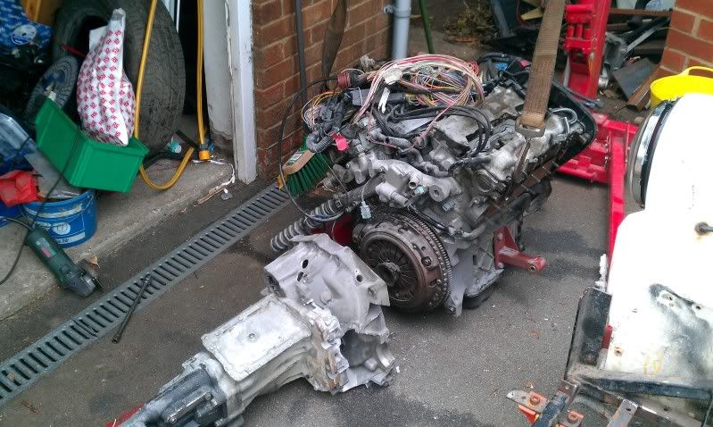

Postby owelly » Mon May 16, 2011 9:58 pm
Finally got a bit of time to play with my Turd.
This morning looked like this...
I butchered this device to make a gizmo for putting beads on pipes. I call it the wafty crank machine...
So coolant pipes made and fitted. Fuel pipes made and fitted. Reverse alternator bracket made and fitted. Clutch master and slave cylinders fitted and working. Tonight looks like this...
Still a long way to go but I'm getting there!!
