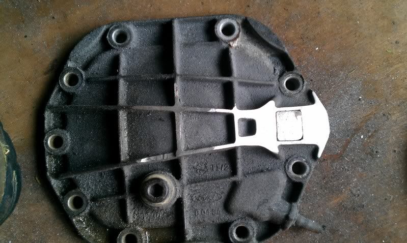

Postby owelly » Mon Jun 25, 2012 8:05 pm
Here's what I'm looking at..
So there's me thinking I have an open diff. However, it seems that Sierras never had proper LSDs. What they had was a viscous pack behind the crown wheel and an open diff. So I DO have what FoMoCo call a LSD.
Anyhoo, here's my holey diff cover ready to be welded...
Postby TeamTotalWankel » Mon Jun 25, 2012 8:32 pm
That makes sense because you use normal gear oil in these LSD's. I knew they were different to a normal LSD but never had one open so that's where my knowledge ends.
