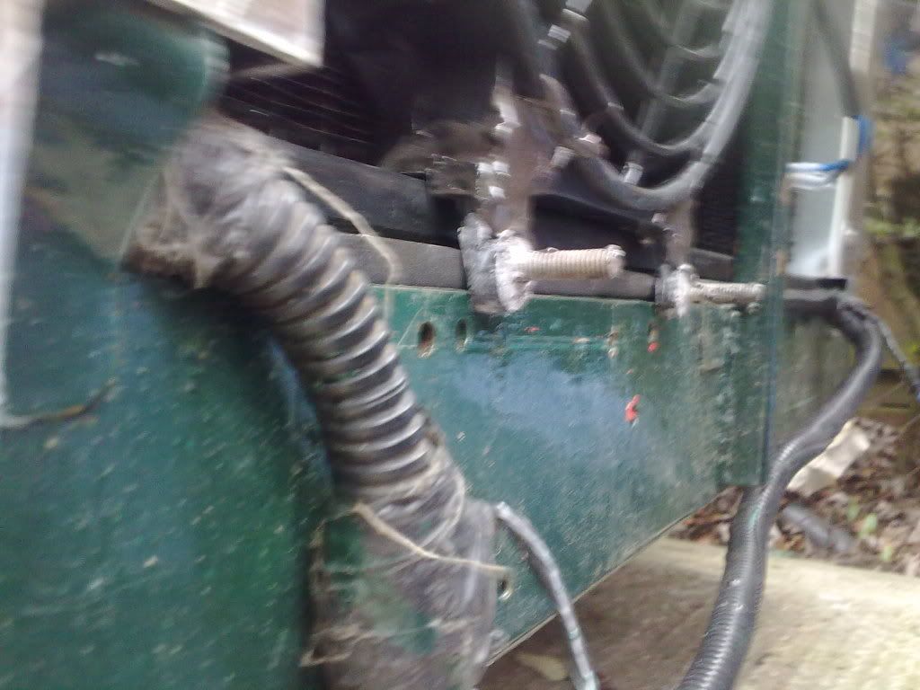

Postby mitsuru » Tue Jun 12, 2012 10:33 pm

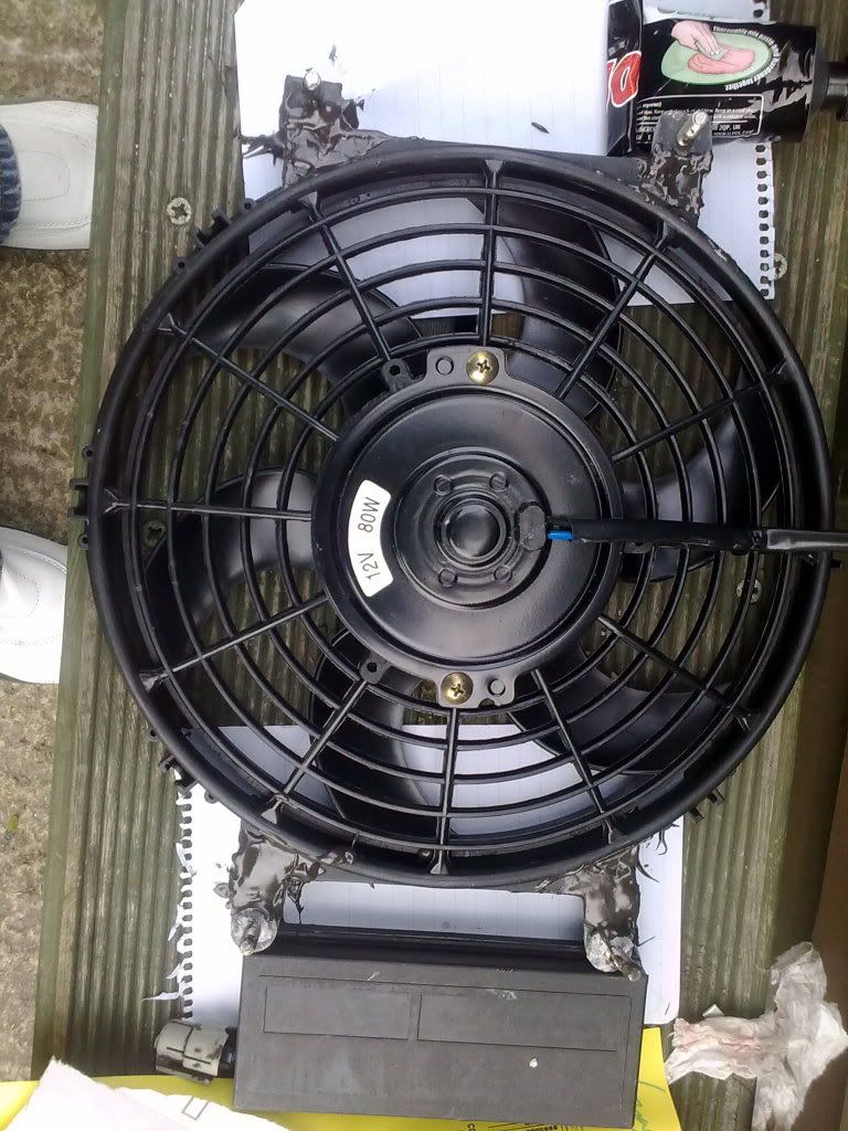

One Radiator fan done so it jut needs a bit of angle iron to bolt
the fan to the slam panel.
The 4 on the right have been trimmed to fit each position & take
a bolt. facing out over.
I made the bumper filler like treacle rather than a paste, this is so
it could be poured into the nooks and crannys sp it filled and acted
like a glue too.
The bolt heads were immersed in the stuff so that the bolts don't
need a spanner to hold them while fitting.
Apart from the pits of metal to bolt between the frame and the
slam panel, that fan just needs the filler filing and smoothing.
One down one to go!

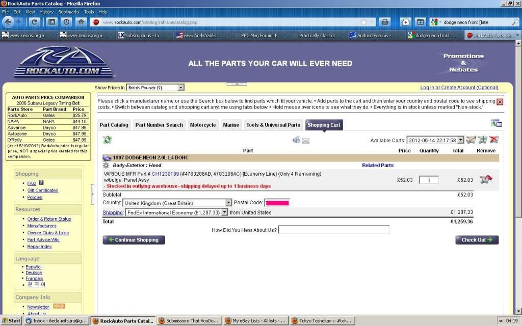

Postby mitsuru » Fri Jun 15, 2012 4:51 am
As my bonnet/hood has been scratched and very shallowly dented
and I was surfing the parts suppliers, I went onto RockAuto's site.
Heres something to have a laugh at, look at the shipping charge!
Oh well I'll just have to get this one seen to by a specialist here
if possible, and it would be a fraction of that price.

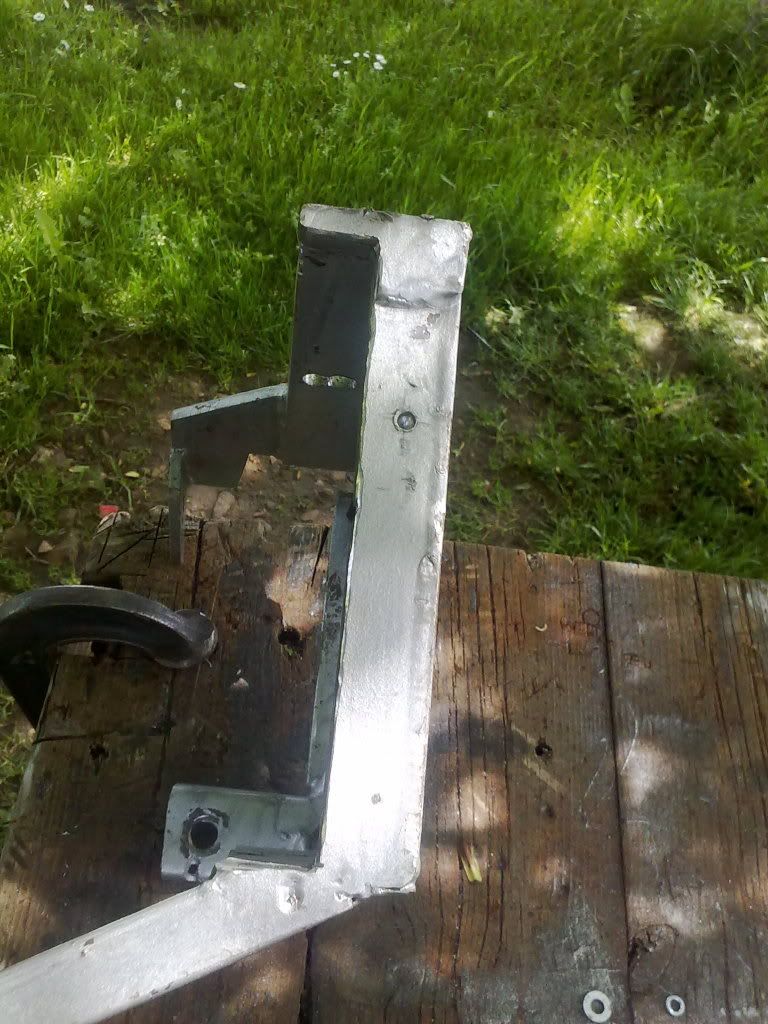

Postby mitsuru » Mon Jun 18, 2012 9:05 pm
As I couldn't get the battery into the tray because the side lip
was too high and the metal backing/frame for the passenger
side headlight was getting in the way. So out with battery tray
and out with the grinder.
Before
After
And after 3rd coat of gray primer
2+ coats of primer to go then the colour.

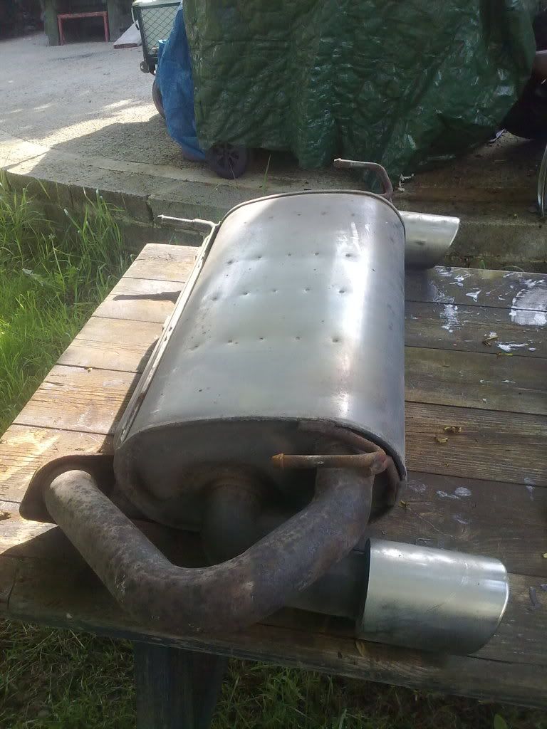

Postby mitsuru » Wed Jun 20, 2012 10:35 pm
A rather large parcel arrived while I was out, and as I was opening
it someone wanted to put their nose in!
The exhaust system was bought off Richard in Ely(Cambridgeshire)
Who I am most grateful for him sending this to me(at my expense)
even though his listing stated collection only. If you do ask you may
be surprised at what the answer may be!
Danny wasn't impressed, he was more interested in my sandwich!

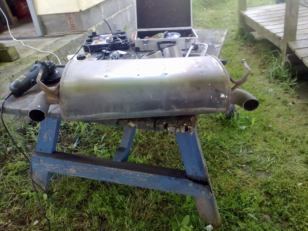

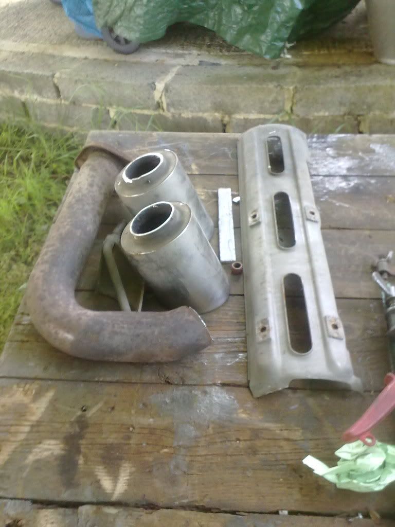

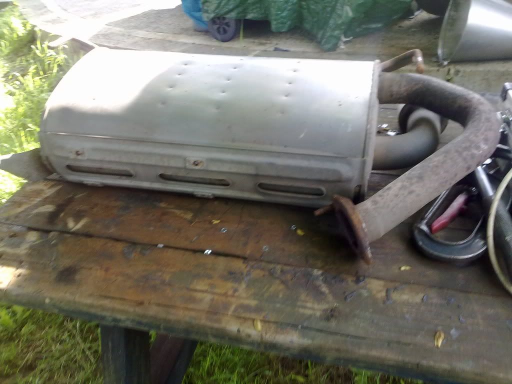

After danny had thhe last of my sandwich I moved the pipes into the
shed I moved the back box to the bench, and removed a rear heat
shield.
Before the cutting begins!!!!!!!

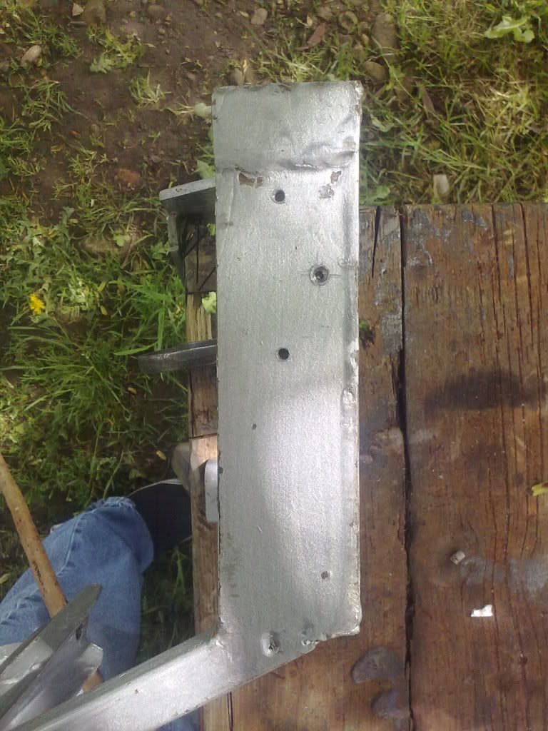

Using the grinder on one side then a dremmil on the other side
due to the limited access, I removed the bracket.
I removed one of the 3 fixing brackets
Now to remove the oversized exhaust tips.
Over 2 inches of the inlet pipe was left after I cut the pipe just before it
bends. This means a tighter bend can be used if necessary.
But it has been cut this way so the back box can be twisted/tilted to suit
the underside of the floor pan.
The bits that were cut off, dad said he wants the exhaust tips, lord knows
What for!
Oh and a new front License plate bracket for a neon is being organised for
me by das2123 who is off neons.org forum.

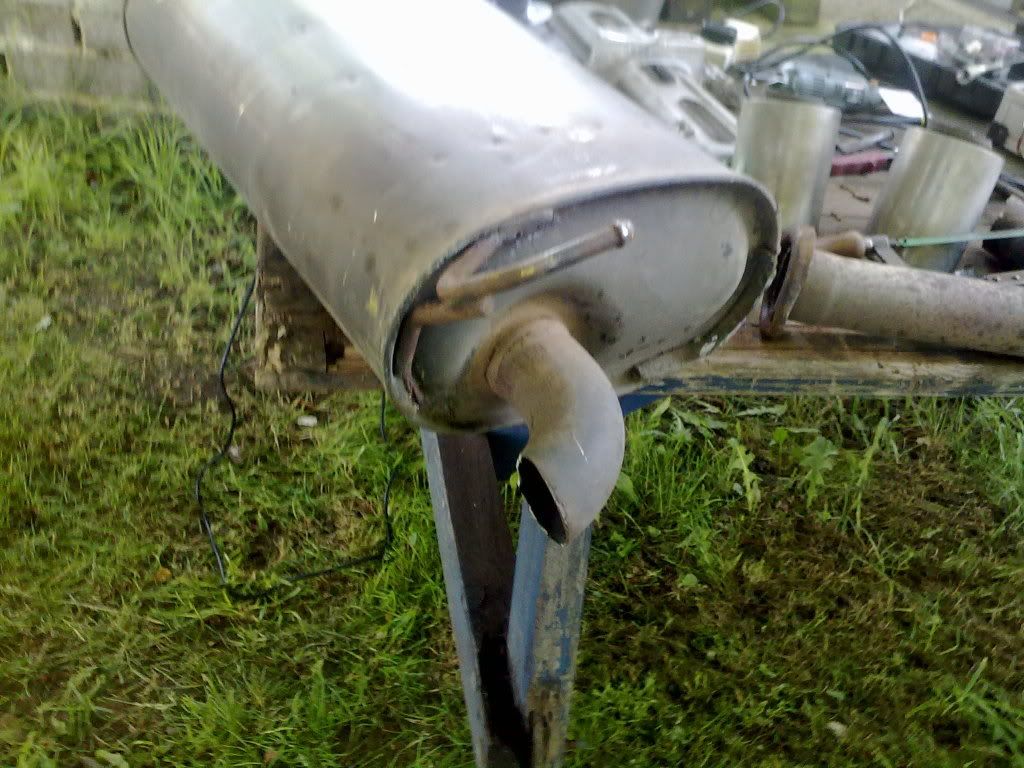

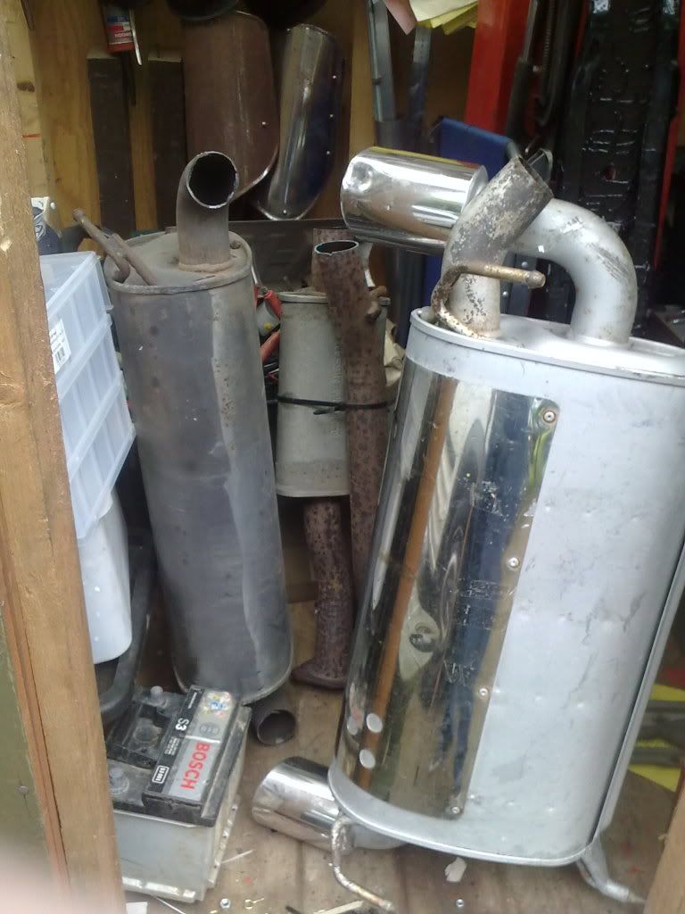

Yes it was the other Nissan 350z mufflers!
Errrrrrr!!!!!!
I can't get in the tool shed now! there isn't even standing room!
I don't now why there is a sheet of stainless steel riveted directly to the
muffler body, in the description it says
ebay item number 270993396902 wrote:It has a stainless shield so that from behind it is not a dull backbox. This adds to the look.
I get the feeling this one might have been modified internally.
Rain again for the next few days, and I had over done it at the relatives, so
I will be spending that time recuperating, ready for a break in the weather.
So expect more side questions in their own threads.
