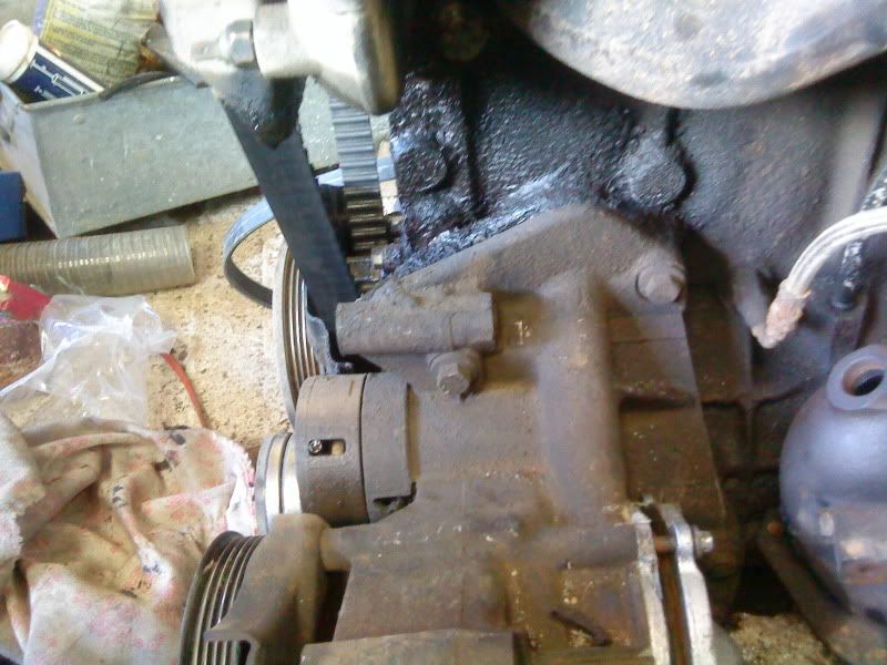

This is the power steering pump and water pump unit. It's a feck-off heavy thing and it bolts over the missing core plug as thought.

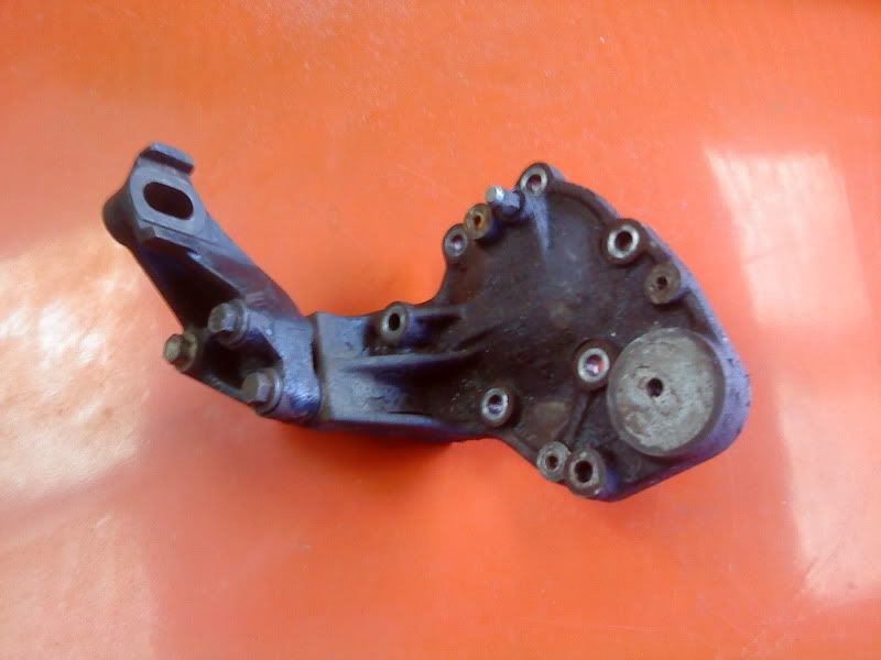

This engine mount:

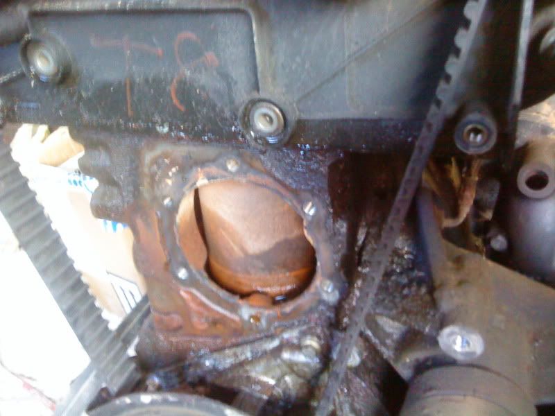

Bolts to the end of the engine betwixt the cam belt and covers the old waterpump hole, thus:
So, where does the K series hang from? If we still need the mount at that end, we'll hack the PAS pump off and cobble a water pump back on but if the engine doesn't need that mount, we need to find a water pump to fit over the water pump hole!! Job jobbed!

The water pump housing is a cast ally unit that has the water pump in the enf bit, but aslo carries the power steering pump and pullys. It loks like the powersteering pump can just be unbolted.
I am right? do i win a biscuit ?

Looking again at the pics of those pumps you've linked to it does look like the PAS pump just unbolts, but that it's needed for the drive for the water pump as it looks like the waterpump is driven off the back of the PAS pump.

Looks like the belt does go round the pas pump pulley before it get to the water pump pulley

That pulley in the middle is the tensioner. The waterpump lives on the end of the PAS pump.

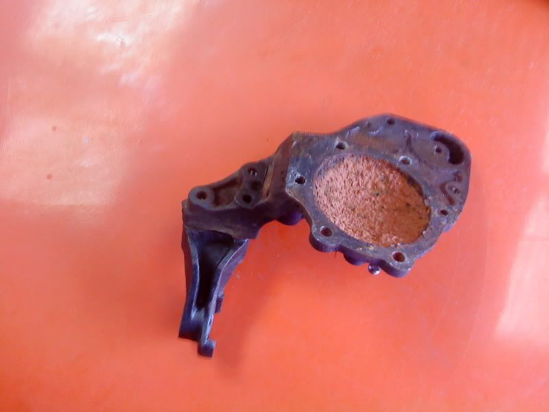

Why is the back of the engine mount full of builders sand?

Its either s small pixie sand pit or the rusty casting core plug cover
