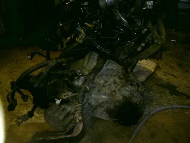

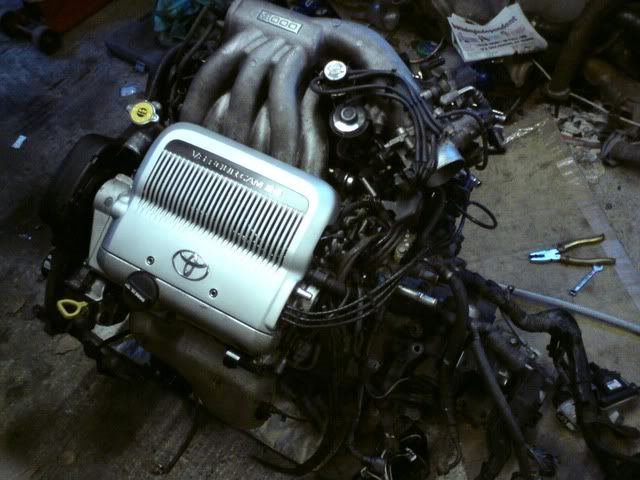

Well, were getting pretty close to finally getting the V6 installed. It's all reassembled after its top end rebuild and gasflowing -

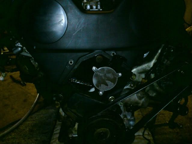

It's got it's new engine mount fitted and PS pump etc removed-
Original MR2 gearbox is bolted in place (only one hole to drill out to 12mm to allow fitment). Unfortunately there's no flywheel in there as I'm still waiting for a mate to elongate the existing holes as it wouldn't quite fit on my pillar drill-
Looking to get it in next weekend (flywheel permitting!!) and then onto the challenge of making some sort of eggsaust for it :think:

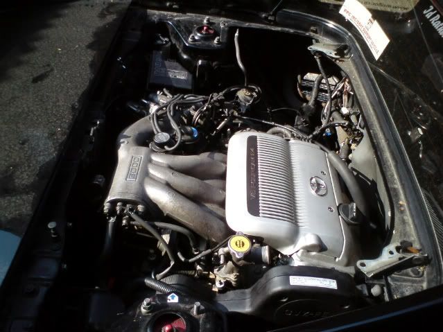

Postby TeamTotalWankel » Fri Apr 22, 2011 4:36 pm
The V6 is finally in there!! Went in a doddle, it's tight in there but no harder than fitting the 4 pot really :D
Seemed rude not to crack a celebratory Stella once she was bolted in place :crazy:
Just the wiring and eggzorst to sort now!! :roll:

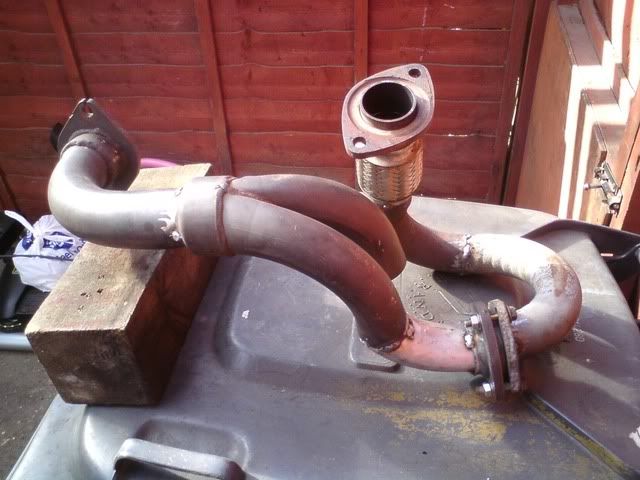

Managed to get a decent crack at the exhaust this afternoon.
Hopefully this was the difficult bit, the rear bank looping round to meet the Y-piece over the rear subframe. I've managed to incorporate a joint (old Montecarlo exhaust from shed :D ) to allow it to split for removal. The rest of the bits are an old MR2 downpipe and bits from the Kwik-fit scrap bin = £0 :clap:
Just tacked at the mo', will clean it all up and weld properly once I'm happy-
Should hopefully mate up to any N/A rear box and de-cat once done.

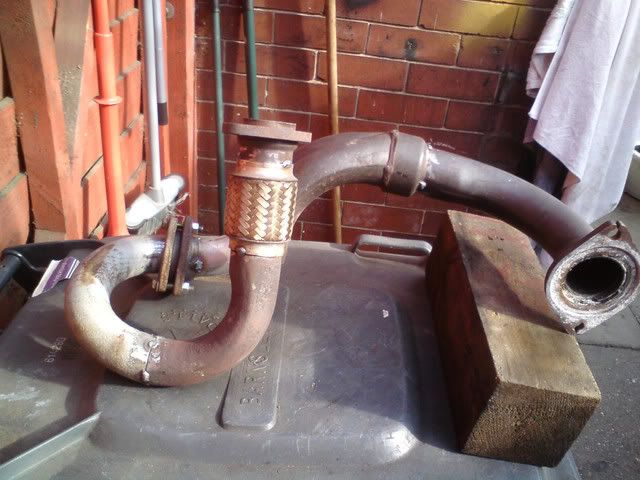

Postby TeamTotalWankel » Tue May 03, 2011 8:54 pm
Got the exhaust welded properly this weekend and just lashed a bit of VHT on it-
Quite happy how it's turned out :D
