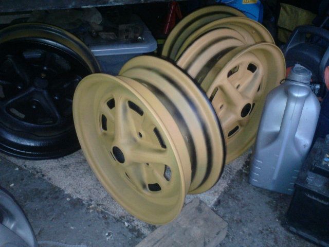

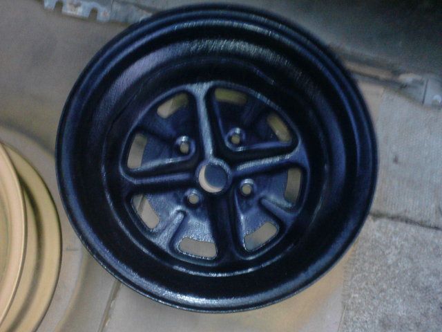

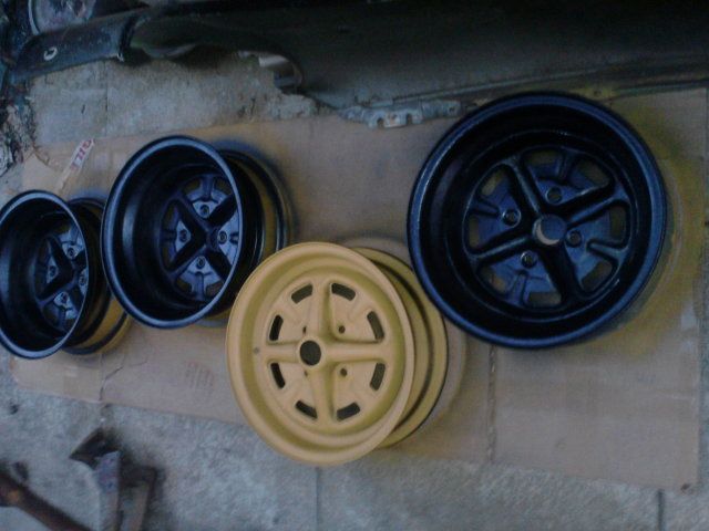

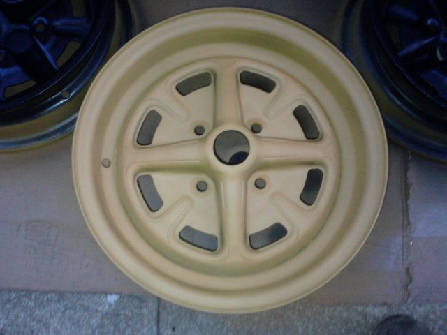

I got the rostyles back today from the chap at work whose son was sandblasting them. They're 90% rust and paint free, and I've just spent this evening sanding down the lips with wet and dry then giving them a coat of Prep&Ready to keep any further rust from developing. I'll keep these on tick over in the background while I'm doing other things. I'll give them a few good coats of high build primer to fill in all the little rust pock marks, then I'll paint them silver. Once thats done I'll hand paint the inner bits black like they were originally. Once thats done they'll get a few coats of laquer and be put in storage ready for tyres.
Postby Renrut » Thu May 24, 2012 9:40 pm
Todays update focuses on the wheels. I gave them a prep and ready earlier in the week and tonight they got a coat of high build primer and the backs then got a coat of gloss black as it was the only black I had to hand. They look quite smart like that IMO but beige and green really don't go together so I'll carry on with the plan of painting the front side silver. Then they'll get a few coats of laquer to toughen them up and they'll be ready to stash away for when they're needed.
Now photos before anyone asks.
