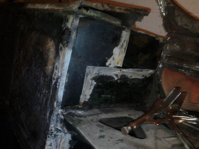

Once that was in and happy I chopped out the drivers side major bodge with Mr Angry. Here is a photo with the floor section welded back in to see how much I had to gut from it:

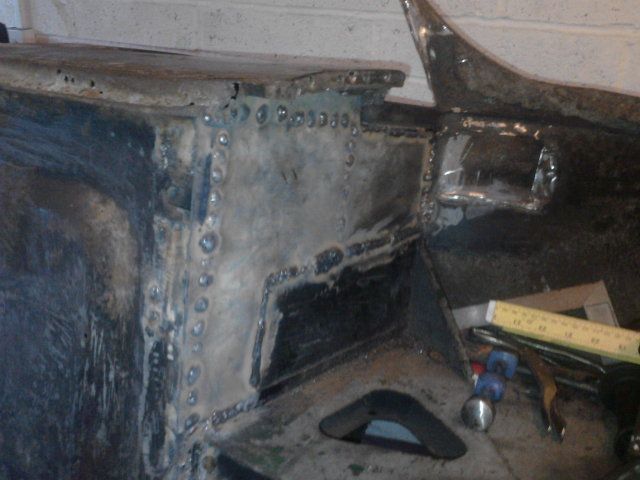

Managed to get some work done on the midget this week. Drivers footwell panel is in!

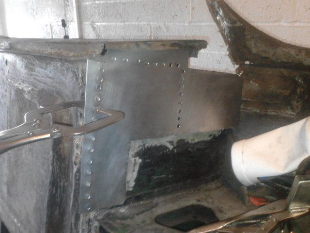

Trial fit of replacement panel. Was good but I'd put a bit much gap at the top, clearly something had gone wrong with transferring the cardboard template to steel :?
Then to ensure things stayed where I wanted them I tacked a bit of 1" angle iron onto the side of the footwell to hold it all straight.
Tacked the panel on then plug welded and a few seams to hold it all square. I made sure I left it a good 5 minutes or so between any serious bits of welding to ensure it stayed straight at this point.
Then I just cracked on and welded it all up
Once it was cooled off a little I set at it with the grinder to clean the welds down. Not as neat as I would have liked but its inside the wheel arch so its not a massive concern.
The lower lip still needs to be bent over to finish it off but I'll do that once I've gone over it again, I noticed some tiny pin holes in a couple of places that need rectifying.
