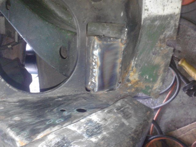

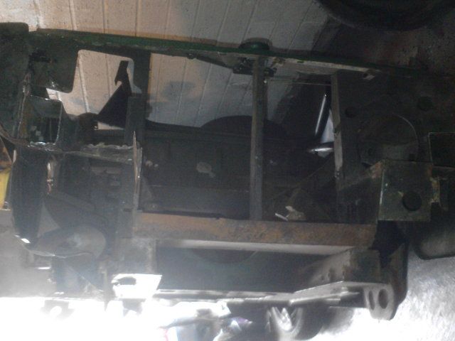

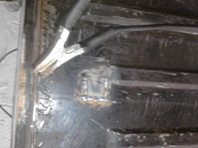

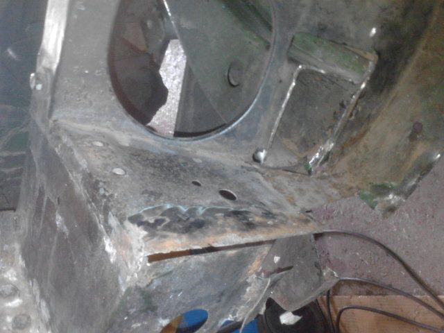

Drivers seat mounting point welded up:

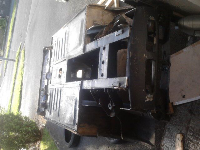

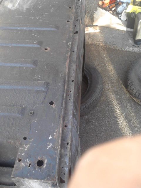

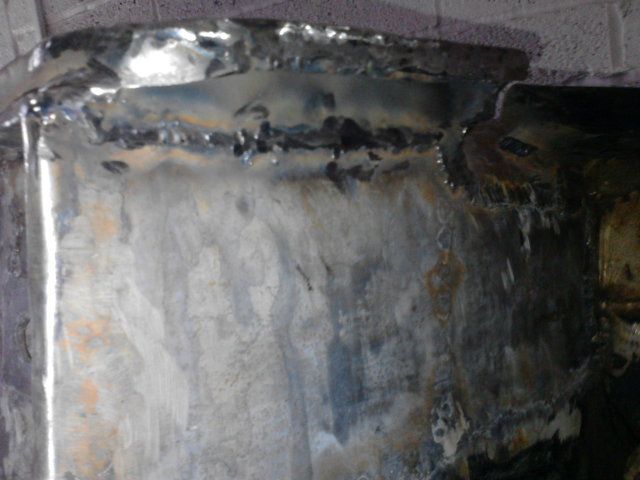

Drivers floor stripped of underseal and paint ready for prep. Still need to do rest of floor but this is the standard I'm aiming for:

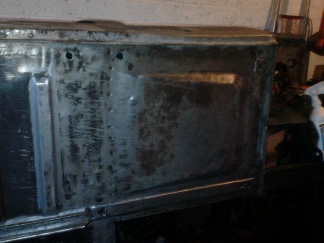

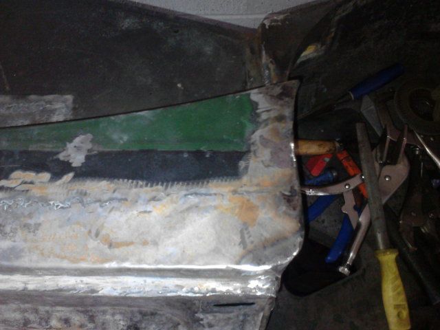

Drivers footwell and sill done for now. Might need to tidy up a couple little bits where I've noticed a couple of pinholes but as the saying goes 'good enough for pit work'. It'll get a skim of filler to tidy it up later.

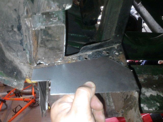

First I chopped out the old rubber bumper mounts. I might cut them further back some point in the future. These were cut out using a sharp chisel and a hammer, couldn't get a grinder or saw in there and just need capping off.

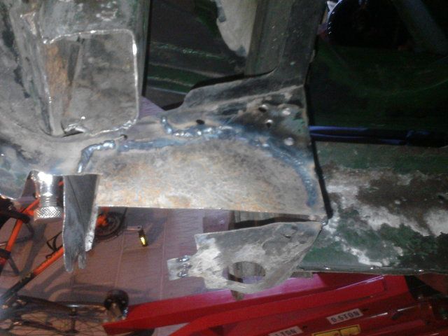

Then I made some progress fixing up where it had rusted out after the front end damage.
Next to clean that bit up and weld on the replacement front valance I picked up a few months back at a bargain price.

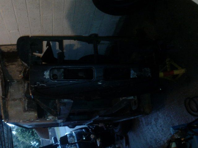

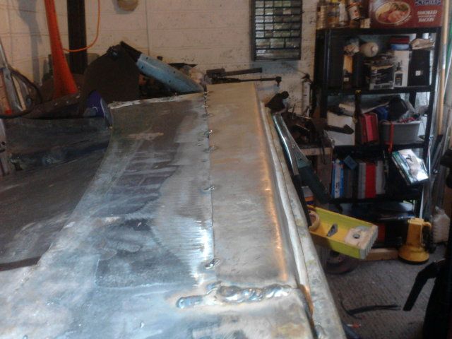

Front valance is now on!
Not the best photo but my only camera is the one on my phone.
A few odd jobs on the front area still to do - inner arch on drivers side plus capping off the bumper mounts where I've cut them down. I suppose I could have just left them be but I'm planning on a mesh grill and it would have looked very untidy.

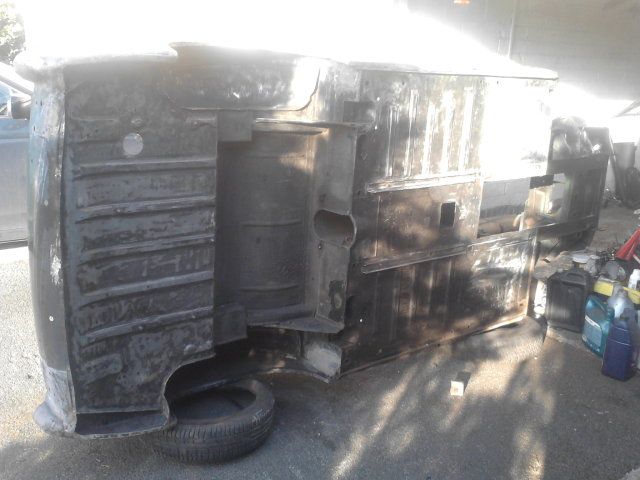

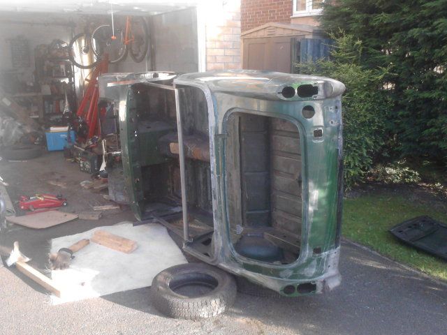

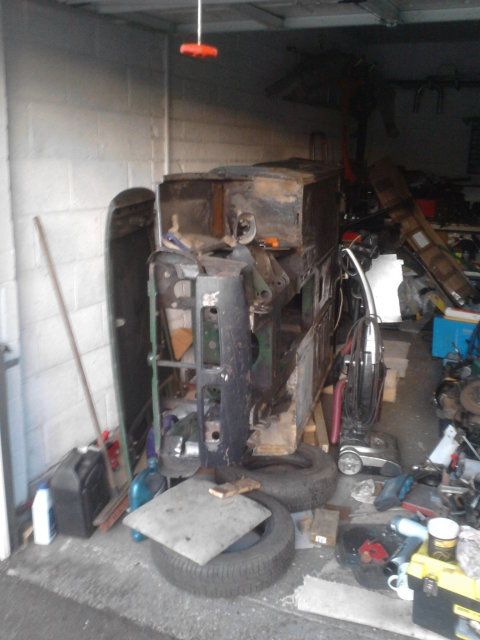

Yesterdays progress was finishing off the front welding, then the fun shuffle of moving the car from one side to the other.
Ended up dragging it out onto the drive, lying it on its roof, spinning it round then pushing it back up on the drivers side. Then finally pushing it back into the garage.
My back is a bit sore today, I probably should have enlisted some help :lol:

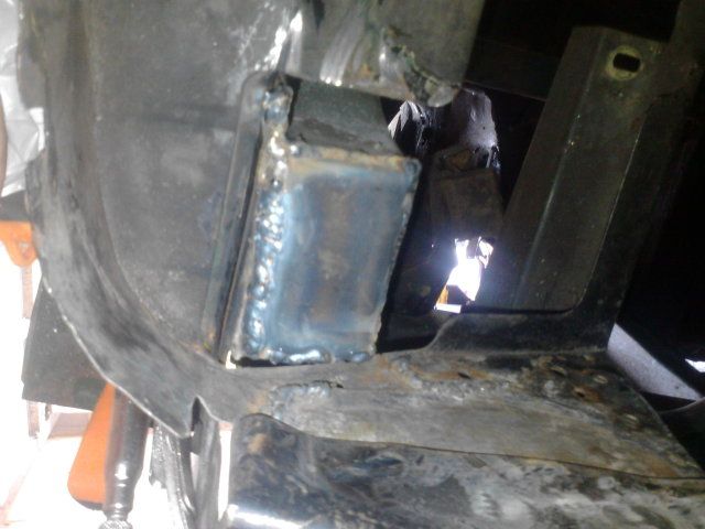

Capped off bumper bars:

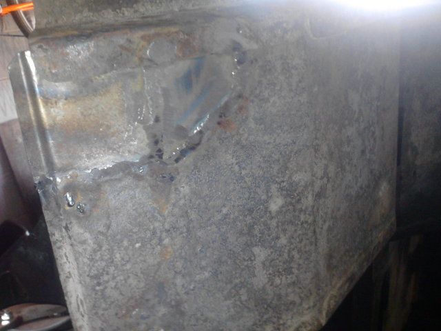

Fixed inner wing
Car out into the sunlight
I can happily report my bracing is good as it hasn't moved at all when I dropped it on its top
Passenger side sill didn't look too good though
From the other side
And shuffled back in
A good inspection of the passenger side says I'll need a new sill. Simples if it wasn't for the fact that the previous bodger had seam welded it to the A post and the B post! :roll:
So I'll order a new one, along with closing panels and then see what I can do with it. Total cost under £60 inc postage. If I feel up to it I'll go and do a rust survey of the passenger side now I can see all the nasties.
