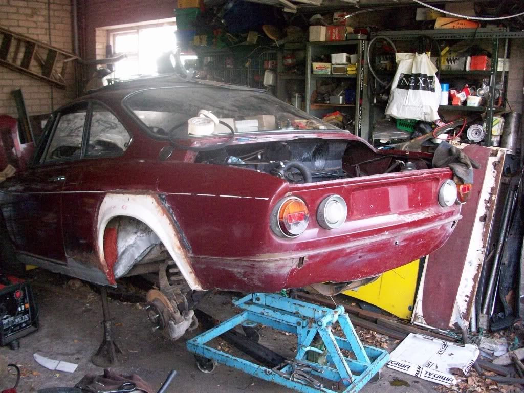

progress on RHD 1200S. Have fabricared inner sill from flanged sheet bought at Newark Autojumble, beefed up inside with rectangular box section. Outer sill is adapted 2 door SIMCA 1100 panel. Total SIMCA 1200S originality 'nerds' could tell the difference but , for me it does the job. Rear arch is temporarily in place. Inner and outer arch was cut back to good metal........yes I did find some eventually!.. then seam welded together. outer arch is a fibreglass panel thanks to the faci I never throw anything away. It is the bit I cut out of a front wing for my Talbot SAMBA oval racer many years ago to fit an Escort bubble arch. It's more or less the right profile for the 1200S rear wing...Lots of bondindg & filling but no more ruat in furure. Now I'm faced with the same on the other side and the front arches. Bits I saved from fitting big arches to SIMCA 1000 saloons will come to the rescue there.....

Moving to other side and, as expected it needs as much, if not more welding. The sill looks a bit better than the passenger side but, I'm not being fooled.... It is a SIMCA 1000 with an Italian Coach builder's body after all = double trouble in the rust stakes.
Meanwhil the engine's now out and I'm working on getting the sheel lifted high enough to comfortably remove the rear subframe, gearbox and fuel tank.

Postby scmick » Thu Jun 14, 2012 10:47 pm
The engine's been put to one side...It runs spot on. Toget the shell up high for welding under the back end, I've unearthed the lift I made when rebuilding various SIMCA 1000 saloons. It was originally the works from under a vet's opeating table. A mate got it to make a lift to work on his motorbike, never used it and it came to me. The hydraulics will really lift some weight... must have been the @Elephant' model in the Vet's catalogue..!!!
