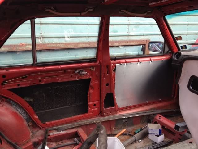

Evening all,
I've had I bit of time on the Merc today, it now has the plastic windows fitted into the rear doors and passenger door.
I've still got to refit the driver's door, so I'll get the window fitted before it goes back on.
The passenger side doors are now finished.
Here's a picture of the doors now:
I've got the fuel pump working again today, I wasn't faulty, the relay was sticking.
All I've got to do now is put some fresh petrol in and give her a go (fingers crossed...)
More soon... :thumbup:

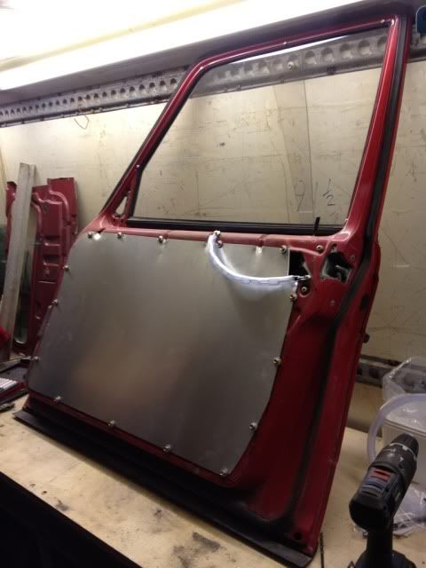

I thought I'd show you a few pics of the work I've done on the driver's door tonight;
Here it is before:
Then my friendly cordless angry grinder gets to work...
Hey Presto!!! A hole appears!!
Then I shaved off the sound deadening with my multi tool, with the scraper attachment fitted...
Then I fitted an off cut of 1mm ali sheet using some self drilling screws, and fitted a chain to the latch, so I can get out of the door.
Job jobbed!! :thumbup:

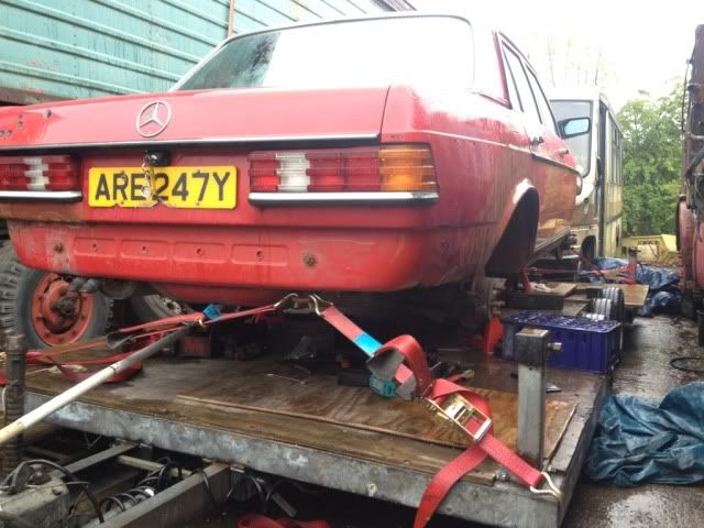

Well, I can tick number 1 off the list, the tank is now refitted. :clap:
Fitting the new hoses was a nightmare, seeing as they are all very short, and all above the rear axle. :wtf:
It didn't help that I was laid under the car, on the trailer getting absolutely soaked!! I spent about 2 hours laid in a puddle. :(
I put the last gallon of petrol in the tank and just gave it a quick spin over, just to check the pump was kicking in ok, and see if I could see any leaks.
The battery was a bit low, but so far it's all lolling good under there. :thumbup:
Here's a picture of my work area today...
I'm going to move the trailer tomorrow, and get the pop up marquee over it, so I can get cracked on a bit tomorrow. :clap:
