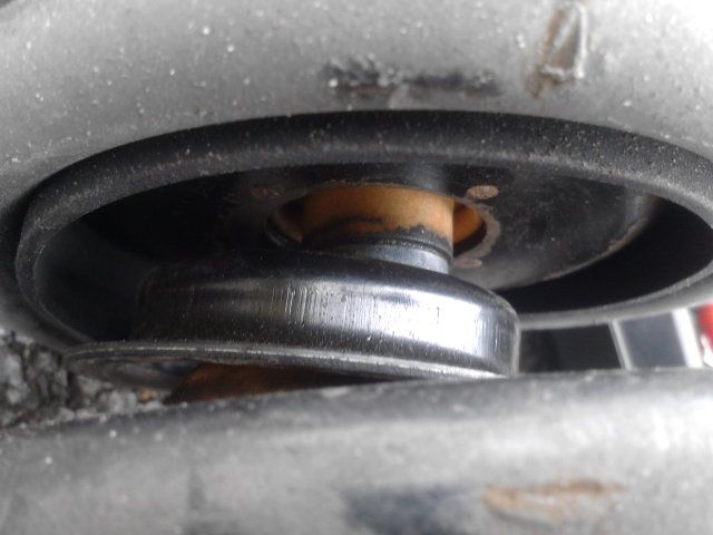

I've had a rattle from the drivers side front end of the jag for about a week now. One of those rattles that only appears when you go over a speed bump or pot hole. Sounded like a nut bouncing around in a recess somewhere. Several times I got out of the car to try and work out where it was coming from. Good look under the car showed no suspension bolts trying to escape so I carried on. Last night I'd had enough though so I jacked the car up and pulled off the drivers front wheel just to make sure nothing was amiss.
Sure enough everything was still all bolted up fast. So I thought I'd see if it was something to do with the shock absorber so I lifted the rubber collar that stops the dirt getting in. It rattled. The rubber collar rattled. :wtf:

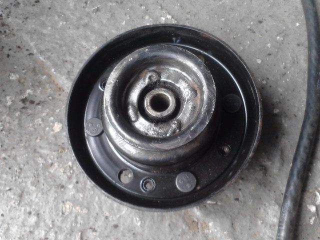

After prising it away to get a better look I discovered a big metal disc with a curved lip sitting around the shock piston on top of the bump stop :?:

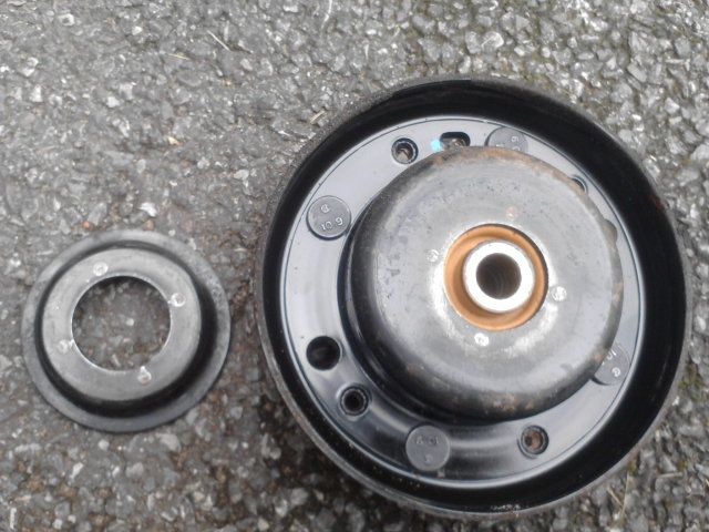

It had 3 tiny rust marks on top of it. Those 3 rust spots perfectly matched 3 on the underside of the strut top mount :think: Looks like the spot welds have failed. I don't think I've ever encountered spot welds failing before the rest of the parent metal. :?

After finding several new rust patches on the midget after an hour of scraping off underseal I realised it might not be on the road any time soon. So I went for G in the end - take it off and fix it :D
Longest bit was waitin for the paint to dry.

I can only put it down to the large number of speed bumps in my area (4 just to the end of the road) and poor quality spot welds in the first place.
They were original jag parts as they still had the labels on them when I fitted the lowering springs and dampers. Dunno if they were original to this car though as it is nearly 12 years old now.
