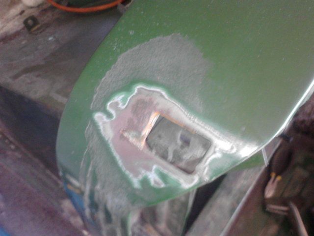

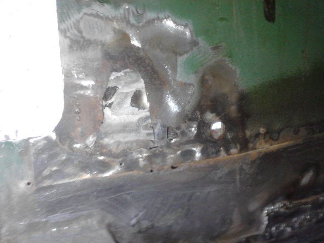

Next I did the passenger B pillar, it needed a couple of little holes welding up. Then the A pillar which was a bit more serious
Top of the A Pillar where the windscreen mounts

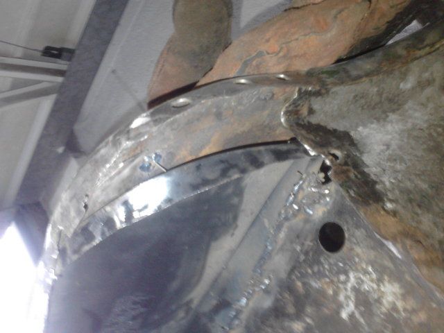

Bottom of the A pillar on the inside

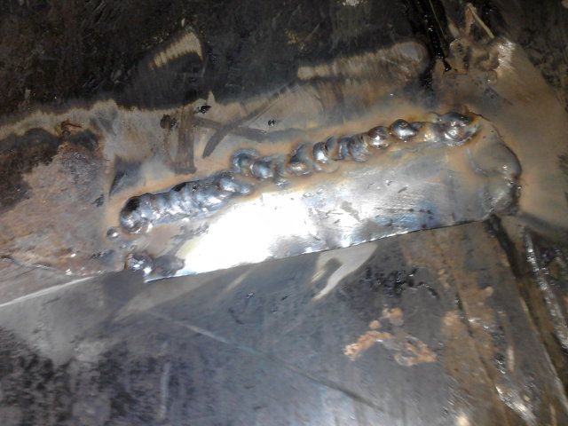

Then I welded up the Inside of the footwell where there was no access from the outside
The welding wasn't as neat this time because I was having to do it upsidedown in the footwell as it was so far in. The proper way would have been to remove the outer sill but thats starting to get into ground up restoration territory. I didn't take any photos of the other bits after I'd done them because I'm a spanner.

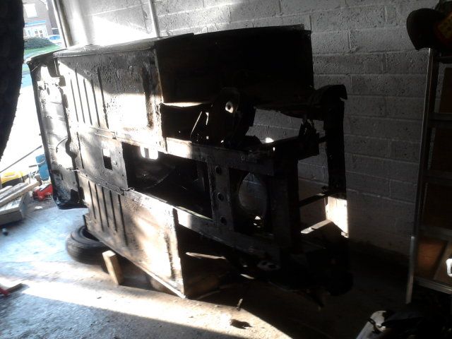

So how many Renruts does it take to tip over a Midget?
One as it turns out :D
Inspection of the underside shows most of the underseal is cracking off, so I'll strip it all off, then start work welding up the footwells. I've also noticed that the back of the tub has a few bits that need more work along with the underside of both sills where they've been hacked about at the front and rears.

There are a few areas of concern on the underside.
First and foremost concern is the fronts of the footwells, they've been really badly patched in the past and as a result have rotten even worse. Cutting out the old patches will be the best way to ensure I get it done properly.
Then there are the fronts of the sills, they've also been badly patched and certainly on the drivers side chopping out will be the best and quickest remedy.
Then there is the hole in the floor where the drivers seat was ripped out. Hopefully only an hour or so to patch that and redrill the hole. Positioning will be the difficult bit here as ideally I'd like the seats bolted in with new runners to get the location bang on. Failing that I'll make up a jig using some MDF to locate some nuts then weld them to the floor so I don't need 6ft arms to fasten the seats in.
Next is improving the awful patches on the inside of the rear wheel arches where they meet the sill.
Finally for the underside is the underside of the rear quarters. Both sides had completely rotten through. I've got the repair panels for this so I'll simply chop the whole panel out and fit the new ones.
The rest, other than some grotty underseal, looks servicable. That'll get a coat of rust treatment followed by some POR-15, then a coat of black paint to protect the POR-15 from UV. Once I've had the car on the road a bit I might put some underseal on top of that too, just to be on the safe side.

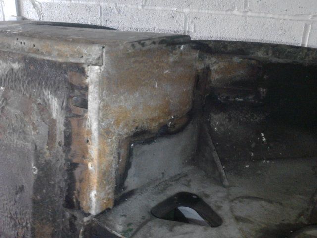

But I have managed to get a few hours on it this weekend. I've welded in the passenger side boot floor corner and stripped all the underseal from the boot floor area up to where the axle sits.
It needs a couple of bits tidying up with the grinder but the rear end of the bodywork is done! :D
Next is to take on the front ends of the rear arches. They shouldn't take too long but they're a bit fiddly.

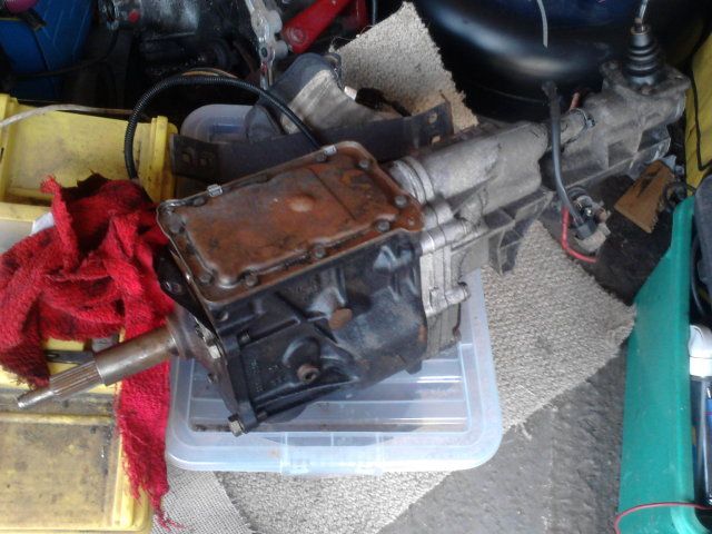

The type 9
Its a 'short input shaft' one. I've got prices from both Titan and Frontline for bellhousings to mate up to it. Both are coming in around the £300 mark plus various other bits, making it by far the most expensive bit of the build. Neither have said if inc or exc VAT though which will make a big difference. I still need to clarify bits like the spigot bearings and the pressure plates.

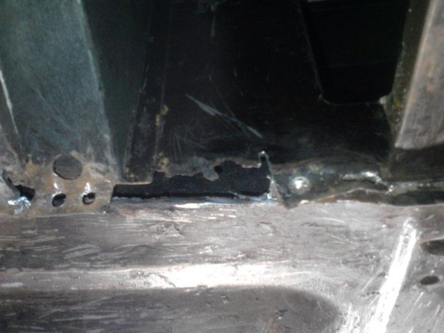

Photos of one of the boot floor panels being fixed (drivers side)
It needed a little extra bit making up as that had also rusted to nothing on the drivers side. Passenger side wasn't so bad.
And here it is, boot floor metalwork finished!

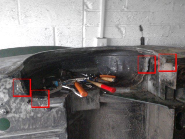

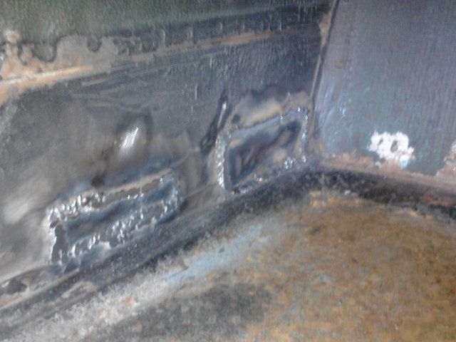

Further progress from today, sorted the drivers side rear wheel arch inner after the excess rust that was found earlier.
Here are the places that were fixed.
Close ups
Still needs to be dressed back but as its all out of sight it won't take long.
