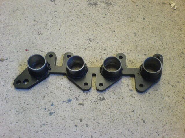

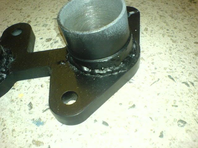

A couple of manifold shots
Nice welding [;)]

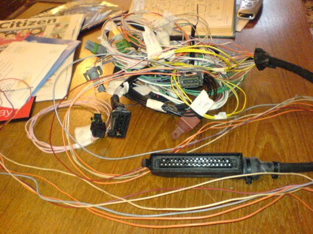

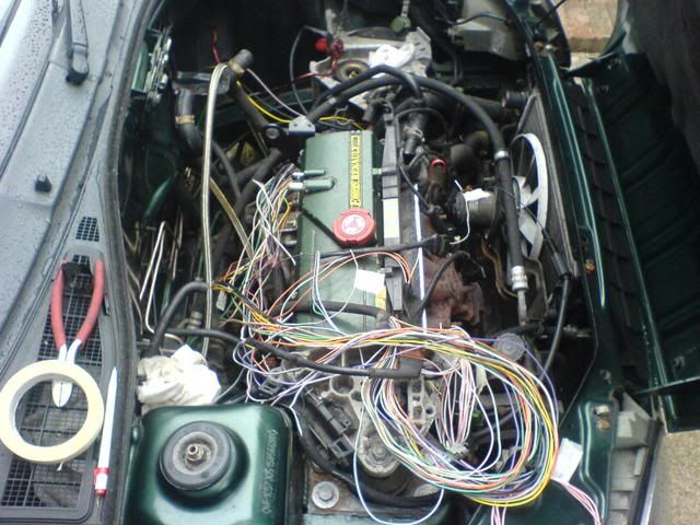

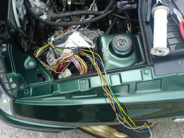

Started to remove ALL the renault ECU related wiring, loom from the ECU here broken out of all the protection so I could see what needed to stay and what could come out,
Eventually got all this removed

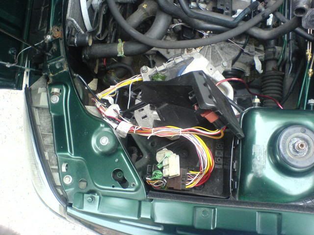

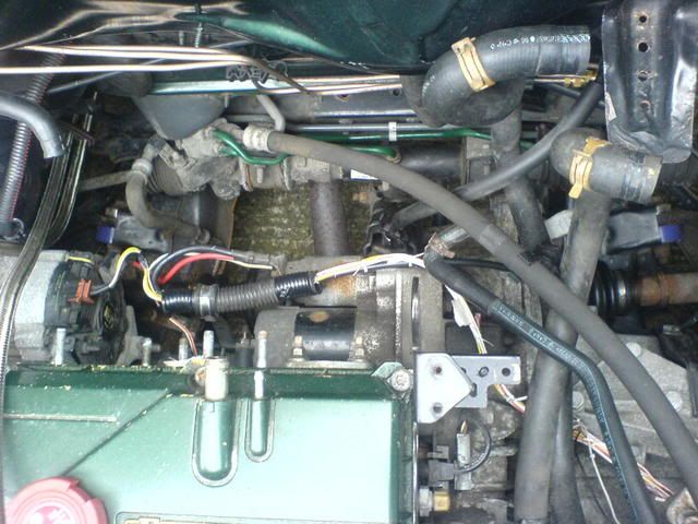

Next 2 pictures were all that I left in the engine bay, top one has all the lights and stuff in, bottom one is the starting/charging wires loomed together again.

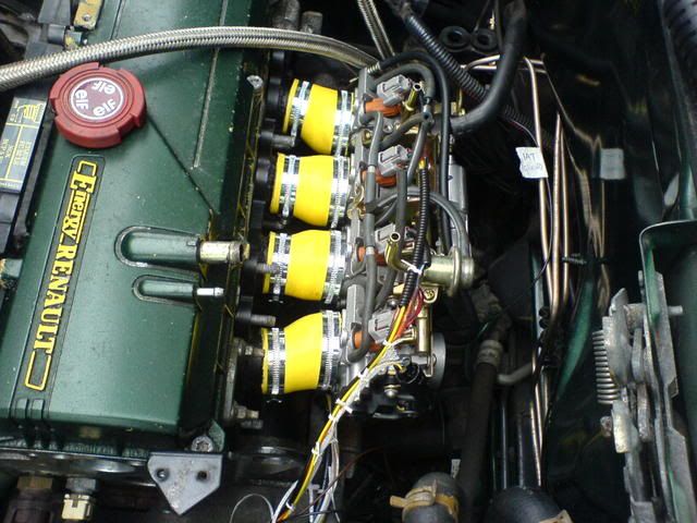

Throttle bodies back in with Injector and TPS wires loomed
This one has old renault loom at the bottom, my loom at the top where the coolant temp sensor and Lambda wiring join
And lastly for now the wires so far that need to go into the car for he megasquirt.
I still need to fit the coilpack somewhere in the engine bay and wire it in, adding the EDIS wires to the loom into the car. I also have all the bits I need to fit the oil temp/pressure gauge on order so that'll be going in this week.

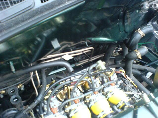

Question(s): The silicone hoses that you have used to join the TB's to the manifold, are they reducers or a bit of straight hose that you have stretched to fit?
Is there much of an internal step where the hose ends and the TB's or manifold start?
Did you find it diffcult to bend the hose to match the spacing of the TB's to then head?
What supports the weight of the TB's? just the hoses?
Thanks from someone doing something similar, somewhere.
crogthomas
Posts: 386
Joined: Tue Mar 14, 2006 10:30 am
Postby spudmurphy » Wed Aug 01, 2007 8:08 pm
Sorry, havent checked back here in a while and when I do I realise I have unanswered questions!! My apologies Crog [:I]
In answer:
<i>The silicone hoses that you have used to join the TB's to the manifold, are they reducers or a bit of straight hose that you have stretched to fit?</i> - They are reducers.
<i>Is there much of an internal step where the hose ends and the TB's or manifold start?</i> - At the manifold end there isnt much of a step as I had to turn the tubes down for the joiners. At the tb end there is approximately a 4mm step (the wall thckness of the tb's)
<i>Did you find it diffcult to bend the hose to match the spacing of the TB's to then head?</i> - In a word... Yes! the outside runners on the inlet manifold are angled inwards, but they should have been more I think. But they fit fairly well for now [:)]
<i>What supports the weight of the TB's? just the hoses?</i> - Yes, just the hoses for now. I think it should be plenty, the bodies dont weigh much and the whole set up as very stiff.
Ta

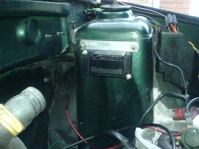

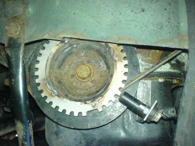

The main progress has been getting the EDIS set up in. The main bit of this was getting a trigger wheel stuck on somewhere, and mounting a crank sensor somewhere near it. The trigger wheel was easy enough, but the sensor bracket took a few goes [xx(]
I got there in the end though, and it looks something like this.
I've also made a bracket and attached the EDIS module to the nearside turret

Postby Evodelta » Sat Aug 04, 2007 12:09 pm
Just out of interest, how did you get the yellow connectors (silicone presumably) to be offset the way they are, I would have thought it impossible to bend them that way, or are they preformed? Did they come with the bike TBs?
Evodelta
Posts: 811
Joined: Thu Mar 30, 2006 3:03 pm
Location: Azerbaijan
Postby spudmurphy » Tue Aug 28, 2007 9:51 pm
<b>Evodelta</b> they came preformed with some of the kink in, I cant remember at this moment who it was I got to make them for me but they were custom..... and dear, about the dearest part yet [:(] Then a little bit of brute force and ignorance got them to fit perfectly [:)]
