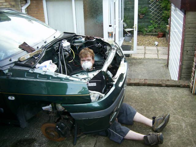

Well that last post turned out to be a jinx. I got the engine back in fairly easily and everything reconnected, plumbed in and bolted up and figured I was ready to go. So fresh start one morning, hot cup of coffee in hand battery fully charged and a spare one on standby I cranked it over, and nothing happened….. absolutely nothing. Quick check over and I’d not wired up the starter motor, phew, easy fix.
With that fixed I made myself another brew, and went to crank it again, it turned, it made oil pressure and then it backfired so loud the small child on next doors drive nearly cried! Definitely wasn’t trying to start though. Must be the timing I reckoned so I made another brew and spent a while double checking the timing, making sure the trigger wheel was straight, making sure the crank sensor was in the right place and the wire was connected. I pulled the fuel pump wiring and tried to trigger light it, for some reason EDIS packs don’t seem to work well with timing lights ? Eventually after what seemed like hours of checking the car over I decided it must be the ECU, gutted time to remove it and retire to the garage with a brew.
Cue several more nights in the garage going over the assembly instructions for the megasquirt, checking and rechecking connections and jumper wires and the mods done for EDIS to work, all checked out fine. Until after despairing for a few days I accidentally poked a wire, and realised it wasn’t soldered to the board, hurrah I’d found the issue, time for a celebratory brew!!
I soldered the wire, reinstalled the ECU, plugged the fuel pump in again and cranked it…… nothing…. nothing….. nothing…… BANG. Hmmm that didn’t fix it, brew time. Must still be an issue with the ECU, about this time Dave Walker was writing in his pages something along the lines of 90% of reported ECU failures were nothing to do with the ECU, well obviously I was one of the 10% and the fact he was talking about professionally built Emerald units and I was looking at a DIY Megasquirt I was doubly sure it must be the ECU.
The car was definitely getting fuel, and definitely getting spark, just nowhere near each other or at the right time. So it could only be ECU related…… maybe. Anyway several more nights of brews, head scratching and posts on the MS forums didn’t resolve the ECU issues, internal wiring was all fine, the code checked out and even my settings were looking reasonable, maybe the ECU was OK.
So one last weekend of trying before I was going to admit defeat and trailer it somewhere. Up early again, made a brew and went out to fit the ECU and battery to the car. Cranked it over a few times and got nothing but backfires, leaned the fuel out and it’d spit out the intake, richen it up and backfire out the exhaust. Everything said timing but I knew that was spot on. I made another brew and now was desperate to try anything so swapped the plug leads around, cranked it over and it ran, it actually ran!
That wasn’t the end of the problems though, the backfires had done a good job of blowing the tb’s off the stubby inlet manifold, the silicon joiners not providing as much grip as I’d hoped and now that it was dragging a lot of air in it wasn’t making very much vacuum on cylinder one causing it to run very lean whilst the other 3 cylinders ran very rich. So the next few weeks were spent thinking up and designing a new manifold, I dabbled a bit with the idea of a composite one but having priced up a suitable epoxy resin that would tolerate heat and exposure to fuel I’ve put that idea on hold for a bit. I also looked at getting one made up by Bogg Bro’s or similar but again due to cost canned that idea and eventually settled on making a better effort than last time from mild steel. A couple of ebay purchases later I had the steel tube I needed and some time spent with a brew, and a pencil and I had a design, and more importantly some angles to cut at. A couple of further hours later, and another brew I had, sat on my bench, one kit form manifold. Just need to glue it together and attach some throttle bodies!

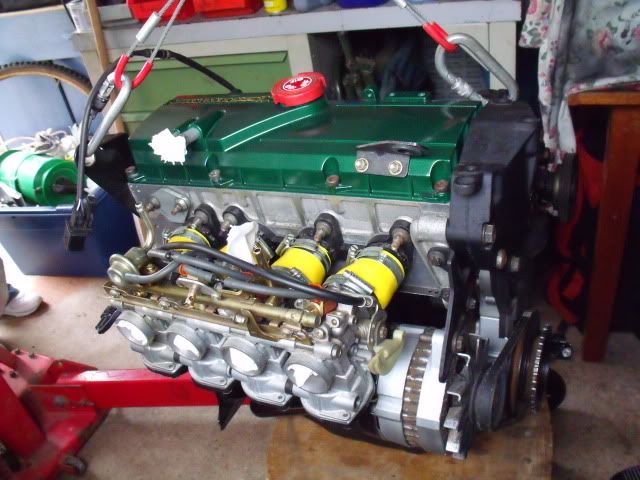

Postby spudmurphy » Fri Dec 03, 2010 12:48 pm
Time for another update, not in any particular chronological order.
The car and engine had been sat for quite not moving or turning so I decided to crank it over a few times on the starter to at least ensure oil was moving about. Gave it a blast on the starter and no oil pressure :? Spun it over some more and still no oil pressure, so checked the sump, oil was present, checked the oil pressure gauge was plumbed in correctly, it was. Spun it over some more, still no pressure, shit.

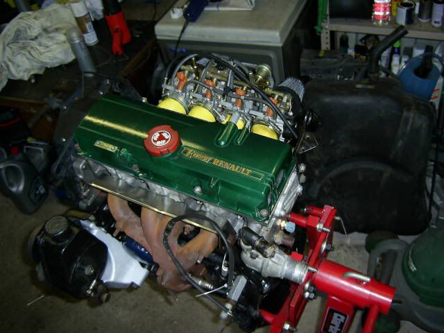

Decided that the oil pump was goosed and so removed the engine and box. Then did some research, and found that with a geared oil pump that if it drains dry it can't create enough vacuum to lift oil from the sump. A classic V8 build trick is to apparently pack the pump with vaseline as that wont shift if the engine is stored for a while. Either that or prime the pump by backfilling it from the oil filter. Having stripped the engine and checked the pump I found nothing at all wrong with it... DOH!!
Took the opportunity whilst the engine was out to baffle the sump and give everything a full freshen up with new gaskets seals etc
Couple of pics of the engine ready for re-installation

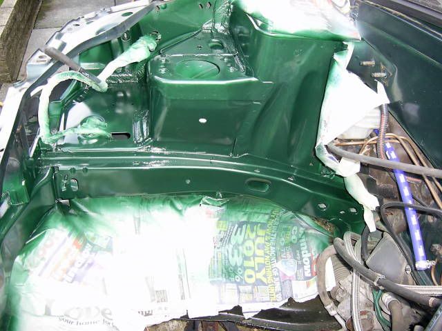

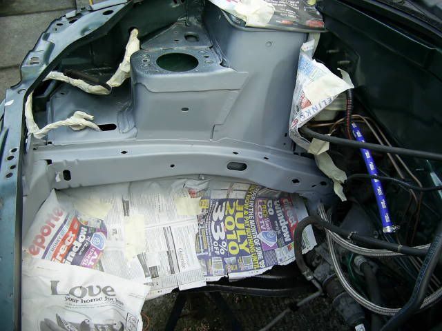

Also decided at this point to freshen the engine bay and subframe up and liberally coat the underside in waxoyl;

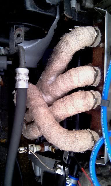

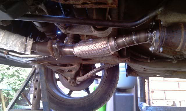

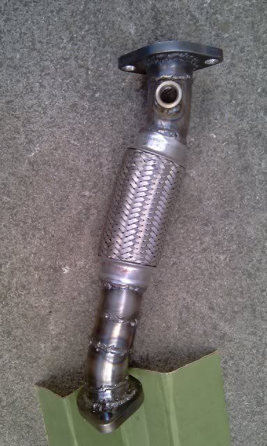

Then we were lucky enough to find a listing on ebay for an exhaust manifold for the renault energy engine, these are as rare as the proverbial rocking horses poop so a last dying second sniping session was employed to ensure a wining bid.
Got the manifold, fitted it and found the first problem, it fit the engine but sure as hell didn't fit the car :roll: nevermind, some more precision welding was employed along with a collection of bits of pipe and flanges from various sources to create this...
and fitted...
wrapped the manifold and fitted it

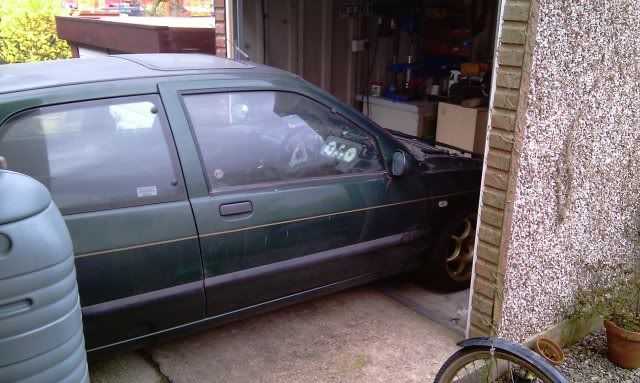

also rolled the car forward almost into the garage so at least I'd be a bit warmer when working on it. This was the first time it'd been back on it's wheels in a long time and I'd forgotten how much of a PITA or more correctly 'the back' working on lowered cars is :cry:

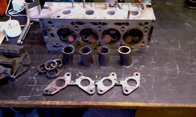

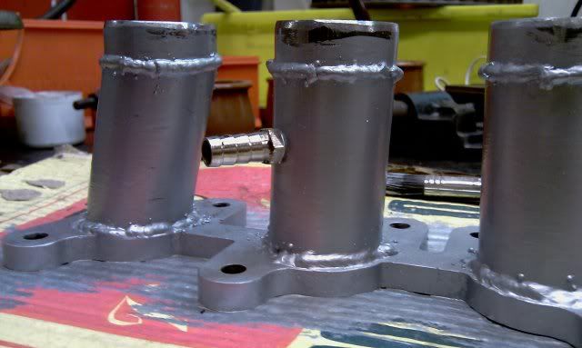

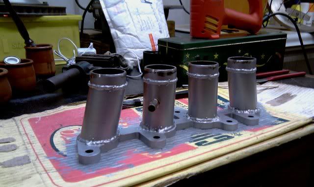

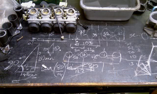

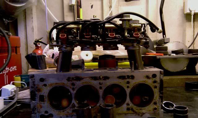

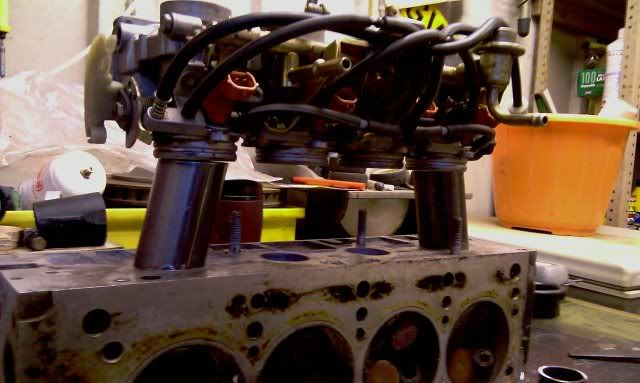

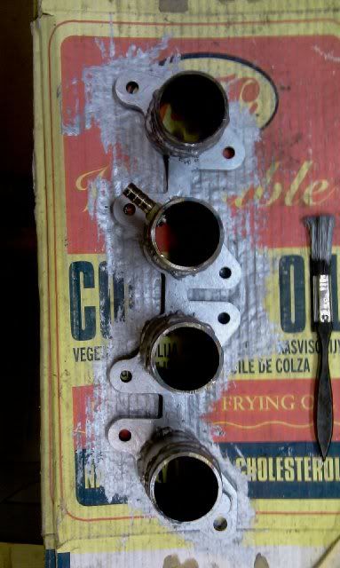

Next up it was time to do something about the inlet manifold and add some structural strength to it. As the silicon hoses had proven to be the weak link I figured removing as much of them as possible would be a good start, more ebay purchases later and I had some steel tube.
Queue some mad scientist type maths to work out port spacings on the head, the bodies, the desired distance between them and the rquired angle of fandangle
pah, who needs fancy catia packages, only a little ironic considering my background in aerospace engineering :lol: :lol:

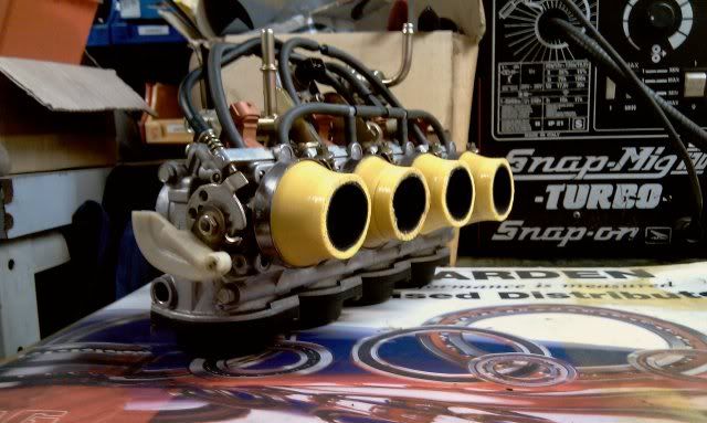

Some cutting later we have a kit form inlet manifold
checked they would actually line up..
cut the silicon joiners down to minimum length
used the metal glue gun to stick it all together and gave it a coating of paint to hide some of the shame
Lessons learned here were that the tubes should really have been chamfered prior to welding to get better penetration, would hav save the welds building up round the outside.
Spud

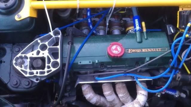

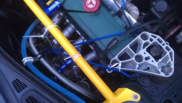

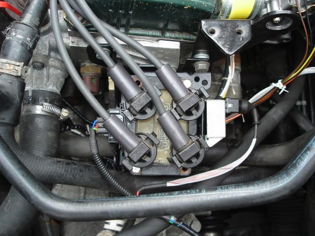

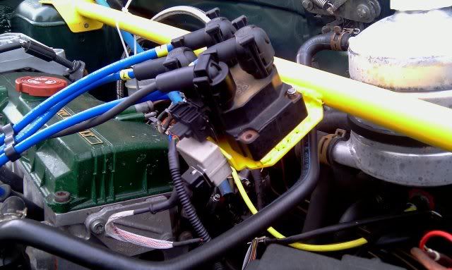

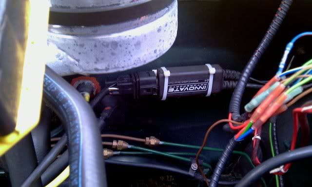

Next everything started to go back together, somewhere in all this I decided that the coilpack that was bolted to the side of the head;
was going to move. I found a strutbrace for a clio, chopped the ford coilpack bracket up and got busy with the welder and the paint again.
And found a suitable new home for the Innovate wideband controller as the sensor had now moved from near the head in the old manifold to in the link pipe with the new exhaust manifold.
Spud

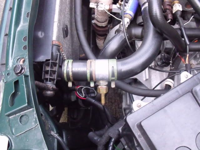

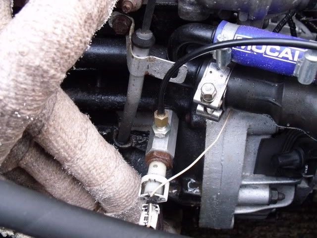

Water temp sender for a gauge fitted, not overly happy with the location as it's after the thermostat and so will only read once the engine is up to temp and the stat opens but it will at least show if things are getting too hot
the gauge is a TIM split water temp/oil pressure one so oil take off added

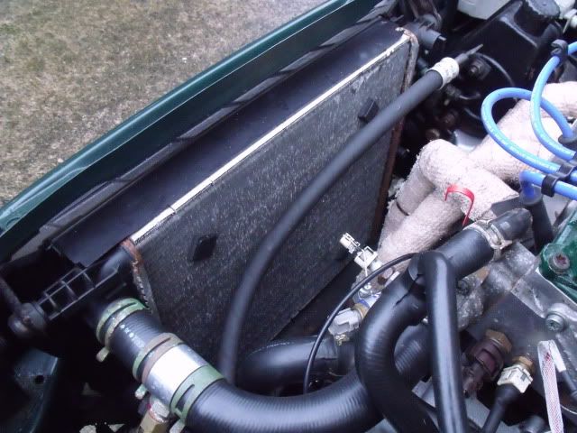

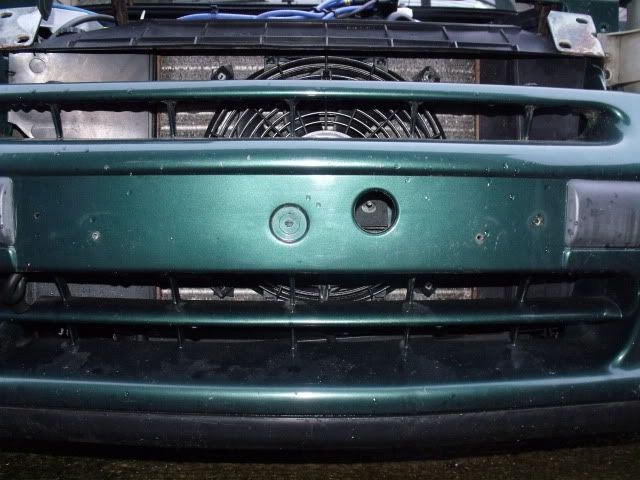

Squeezing the new manifold in didn't leave much room for the fan so we've gone for a front mount one. Verdict is still out on this too, it cools the rad down fine once the engine is up to temperature but it's not been trialled on the road yet to see if it obstructs flow too much.
Back view
Front View

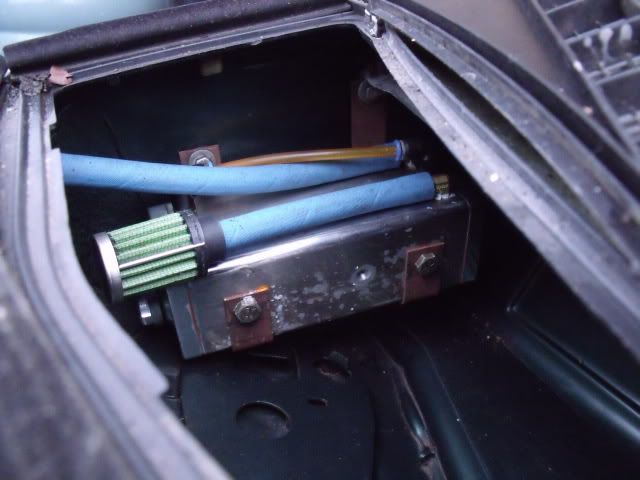

In the scuttle area that used to hold the ECU an oil catch tank has been added. It's a cheapo ebay one for now, planning on getting something better made up with better size breathers once it's up and running.

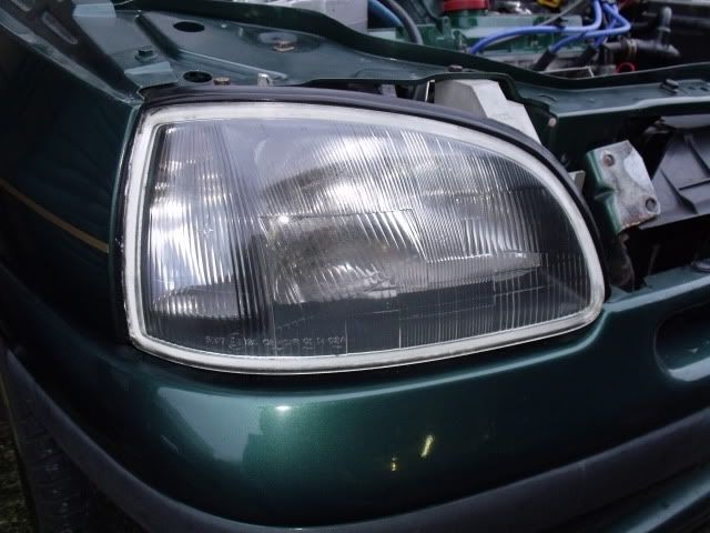

Another mod I've tried is painting the insides of the headlights. Not seen this done before on a clio so not sure if I'm trailblazing or not. When removing one of the headlights the glass fell off, common problem I've since found out. With the glass off the idea came up of painting the insides black, we've also removed the lenses over the indicators and fitted some silvervision bulbs to avoid orangeyness
Again, I'll wait and see what I think of these once it's up and running.

Postby ST182 » Fri Jan 07, 2011 6:14 am
spudmurphy wrote:In the scuttle area that used to hold the ECU an oil catch tank has been added. It's a cheapo ebay one for now, planning on getting something better made up with better size breathers once it's up and running.
funny that, it looks like a free one off mr st182 to me :wink:

Postby spudmurphy » Thu Jan 13, 2011 1:55 pm
ST182 wrote:funny that, it looks like a free one off mr st182 to me :wink:
:oops: :oops: eeek, you're right you know! lol
Sorry pal, it's been that long between you donating it and me getting my ass in gear and fitting it I'd forgotten it's origins! Well reminded and credit where it's due for supplying parts to the longest project ever :lol:
