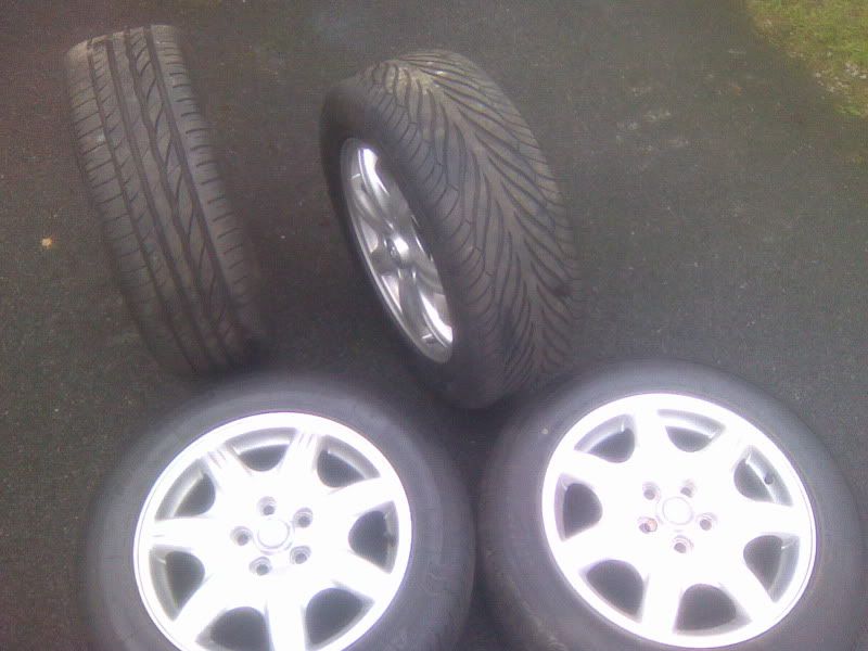

New wheels and tyres:
Image (before anyone asks yes they are made from moon dust)
A pair of Avon ZZ3s on the front and Bridgestone ER300s on the rear. Figured this car eats rear tyres so with the harder touring ones on the back they might stand a chance.
Changed them over yesterday and learned a valuable lesson - don't try to remove and replace 4 wheels using a 12V impact driver without the car running - it flattens the battery! :oops: All fine now after a an hours charge though.
Now I need to decide what to do with the 18" BBS split rims as they're damned bulky and I don't have a lot of storage space. They need a refurb which I'd do myself but it might take some time. Might enquire about getting them done by a pro, anyone know a good one in liverpool/manchester/west yorkshire area? New ones or refurbs go for about £800 :o so well worth doing.
And I've ordered a new sump gasket and idler pulley as the squeaking has become very annoying! Turned out the cheapest place for the parts was the local jag dealers (Rybrook in Warrington). Really beginning to like them, always helpful, even emailled me the pictures of the belt system so that I could be sure of getting the right part. Should have it all in on saturday morning for me to get it all done this weekend :thumbup:
