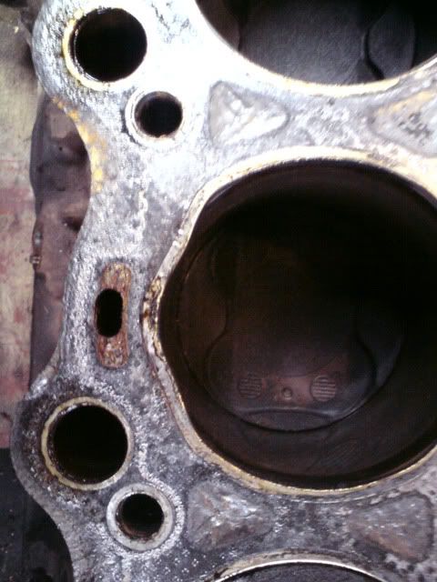

Good progress made this weekend. Old 4 pot out of car and collected by new owner in exchange for 250 beer vouchers :crazy: Started stripping the V6. Took me about 4hrs to get one head off!! :wtf: Loads of wiring, pipework etc etc (and I was a bit hungover :lol: )Certainly wouldn't want to do this when it was in a car. Anyway, its looking good inside - all nice and clean and the bores are perfect :D However, I think it's safe to say that the headgasket had gone-

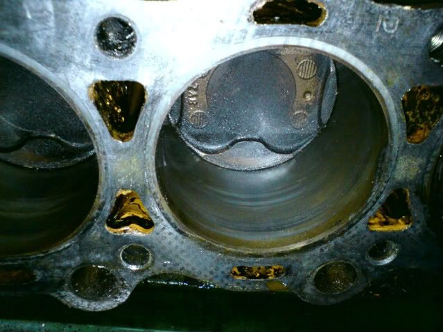

I'm fairly sure this engine has done high miles but it's impressively clean inside, so looks like it may have had a pampered life-
No sign of bore wear either-
Postby tommi » Mon Nov 15, 2010 11:28 am
pistons look epicly clean. you dont think maybe it was run a little weak/hot. whats the head like ?

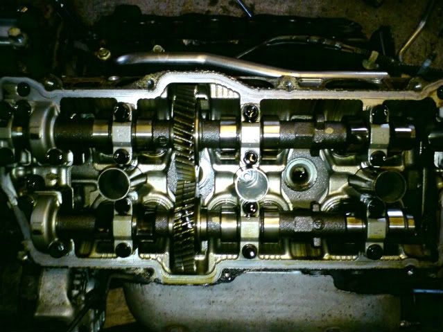

Postby TeamTotalWankel » Mon Nov 15, 2010 12:25 pm
Head's nice and clean too, looks spot on. :D
Yes it was running hot, that's why it ended up in the scrap yard. They'd gutted the 'stat to try and cure it but gave up after that. Looks like I've found the issue though.
Postby owelly » Mon Nov 15, 2010 1:42 pm
HGF often leaves shiney piston crowns due to the steam cleaning they get!
