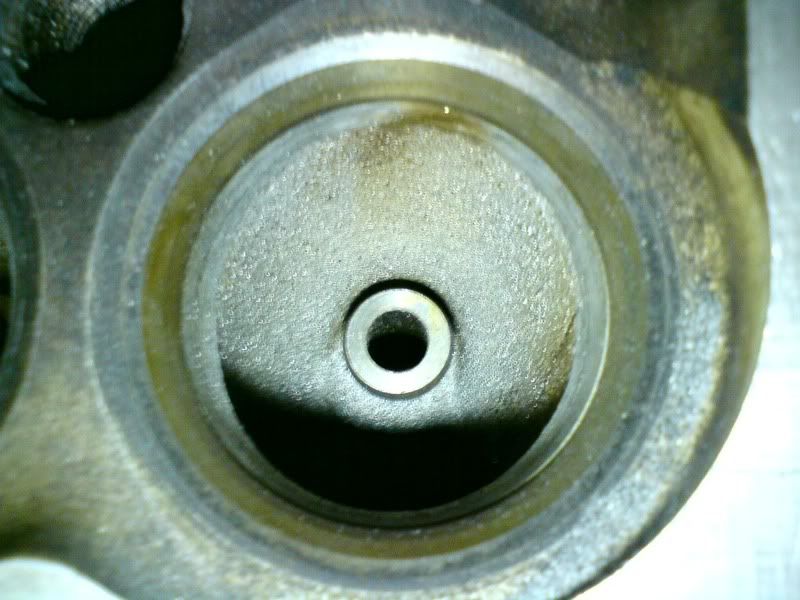

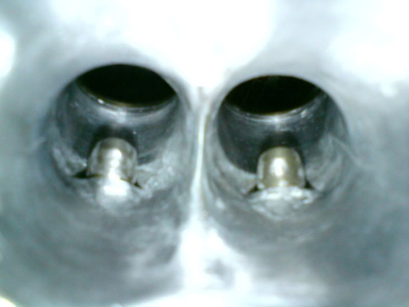

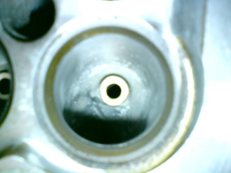

The engine was stripped and cleaned last weekend. The heads are on the bench and I've started porting them but -5degC handling an air die grinder is not really ideal!! :o It's awkward to do a neat job with the guides still in so I'm considering grinding them flush with the ports maybe just on the inlets. What do you think?

Inlet port before-
1st attempt with guide in place-
Before-
After-
Before-
After-
Postby tommi » Mon Dec 20, 2010 6:44 pm
did you take quite a lot out?
Postby TeamTotalWankel » Mon Dec 20, 2010 7:12 pm
tommi wrote:did you take quite a lot out?
No not really, just took the casting marks out mainly. The main bits are smoothing out / rounding the SSR, guide boss, splitter and where the valve seats are machined in.

We always cut back valve guides on 'race spec heads', ports have come out nice mate.

TDC wrote:We always cut back valve guides on 'race spec heads', ports have come out nice mate.

Ta Mark, I'm just a bit concerned about how much guide will be left if I take them down flush. And if it's really worth doing on the exhaust side? :think:
