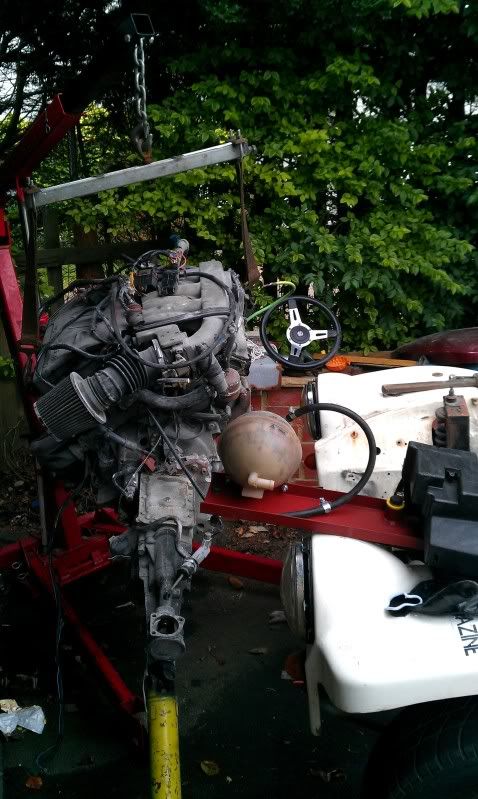

A bit of an update for the Tupperware Turd....
Engine and box out...

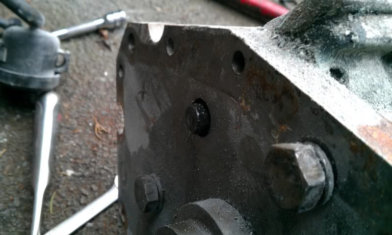

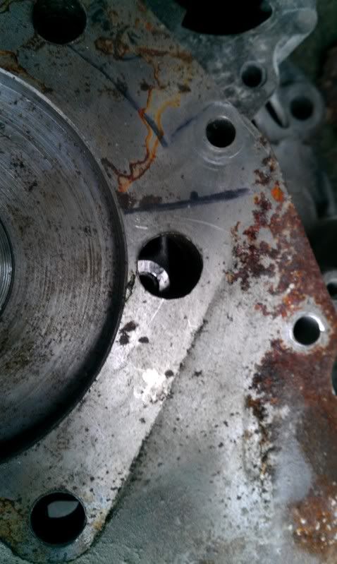

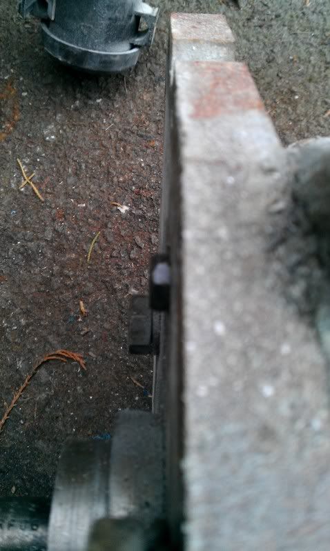

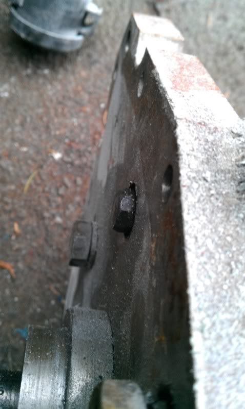

And found that the reason why 2nd and 4th gear didn't want to play...
The oily bit poking through the adaptor plate is the gear selector shaft and it was hitting the bellhousing gubbins, thus....
Mr bellhousing met mr angry grinder......

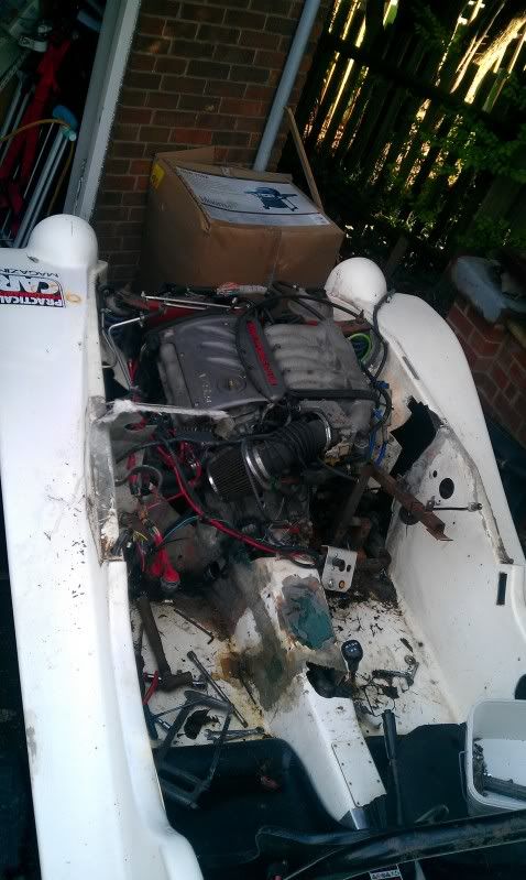

Engine and box are now back in the car just waiting to get all it's ancilliaries connected up.
JUst a few more fibreglassing sessions to get the bulkhead back in 'shape' and that's a few more things ticked off the list.

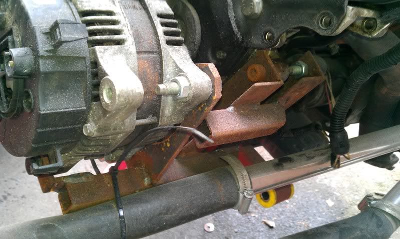

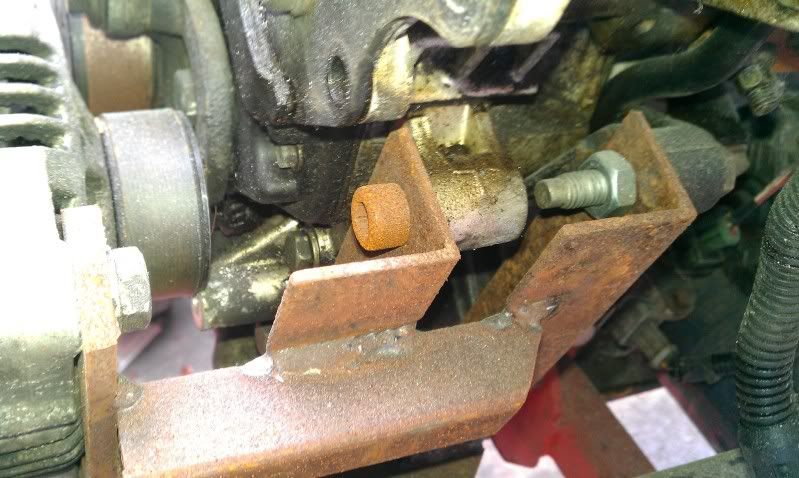

And whilst I had the engine out, I thought I'd take some piccies of my inside-out alternator...
Obviously many folks have told me it won't work but it's run for a couple of hours like this and spurts out 14volts and I can't see it needing to work for much longer than that...
Postby fha772 » Sat Sep 03, 2011 12:23 am
Looking good Owelly, I can't see why there should be a problem with the alternator, so long as it's spinning, it'll produce power, which ever way it turns. (I know telling you this is stating the obvious!!),
I'm glad to see the gear change problem was a fairly easy fix :thumbup:
Keep up the good work!! :clap:
We need our resident celeb at the £999!!! :wink:
Posts: 4955
Postby Jaffa » Sat Sep 03, 2011 8:03 am
Normally the only issue with running an alternator the wrong way would be cooling wouldn't it?
Postby MFrV1 » Sat Sep 03, 2011 9:07 pm
If the alternator fails, what about a Honda one? The engines are known for spinning the 'wrong' way.
