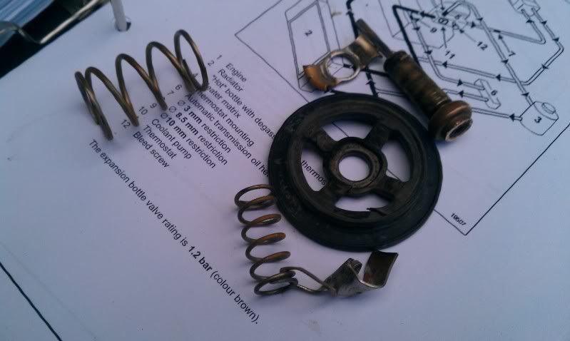

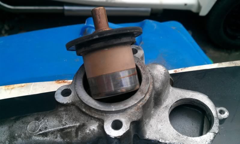

Well, I decided to have a looksy at the thermostat.
You can see it's been moving and according to my Pug V6 bumf, it has to move 9.5mm. The slidey marks confirmed it had been moving but it was stuck solid when I tried to pull it out! It slides through a rubber lip seal and this seal had gone hard. A part of the lip on the seal had folded back and it looks like this was causing the stat to stick. So, rather than try to buy a new one, I did this...
That's right. I took a photo.
As the stat form a seal between the ally waterway/tube/casting thing and another waterway/tube/ casting thing, the flange <<snigger/>> had to be refitted, so I pulled its guts out.
Now all of the rad gets hot and the fan keeps things under control. All good.

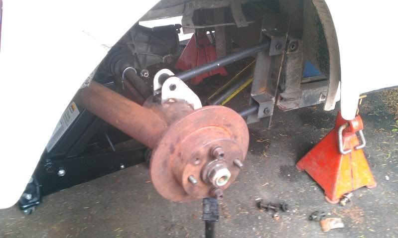

Postby owelly » Fri Jan 20, 2012 11:18 pm
....any way. As the car was working fine, I did this...
Posts: 6407
Postby owelly » Fri Jan 20, 2012 11:21 pm
And started to fit this.....
Posts: 6407
Postby TeamTotalWankel » Fri Jan 20, 2012 11:34 pm
