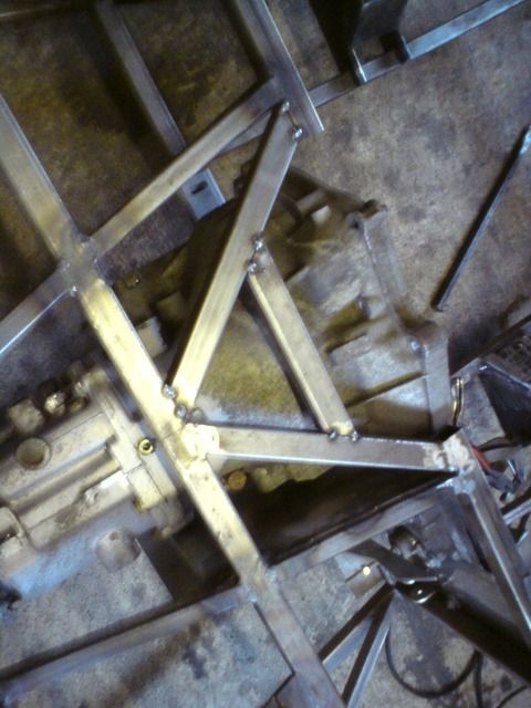

He's tacked together the triangulated bracing to strengthen the area where I had to cut out the cross piece to get the gearbox in. He did complain that he was getting tired when using the junior hacksaw to cut the pieces to lenght :roll: Suppose he's only just 7 :wink:
Both eng mounts are tacked in place ready to be seam welded now-

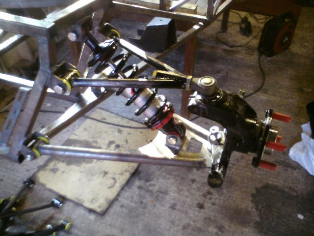

Thought I'd take a look at the set of AVO coilovers that came with the chassis. They're supposed to be 13" open 9" closed. Turns out one pair are 14" open and the others 12" open, DOH!! They're about £400 new so I called AVO to see what they could do. They were very helpful and said they could fit shorter rods to the long ones and extended top eyelets to the short ones, and service them at the same time - all for £25 per shock!! :clap: They got them Monday at 4.30pm and I had them back Thursday morning :D Et voila, four 13" shocks for a total of £132 inc vat and p&p.
Did a quick trial fit of the front suspension before I start to paint the chassis-
