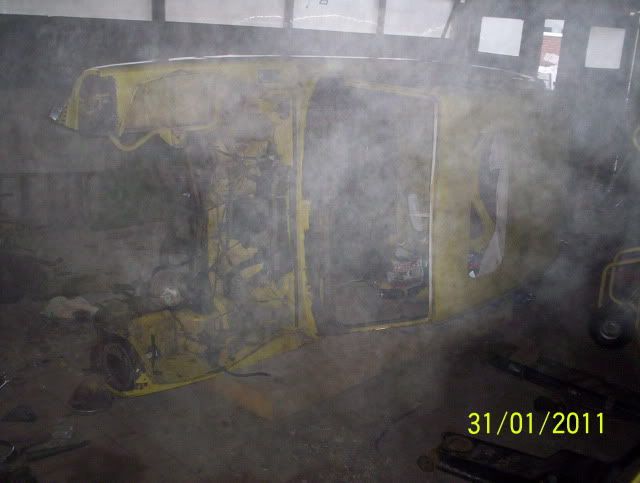

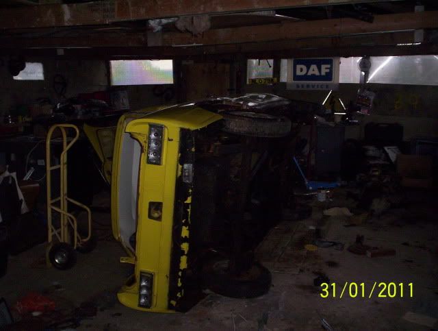

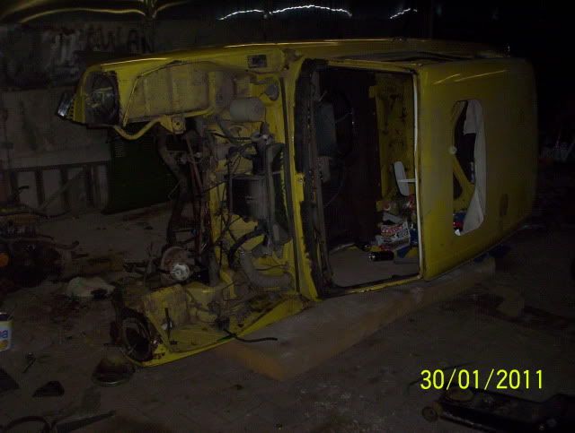

Stripped out the engine and rolled it on its side for all the running gear to be removed, trim and glass already out.
If anyone on here knows Dafs, not that likely I know you will realise that this is a later Daf 66 shell and not a 44, The shells are the same from the A piller back and I have all the early panels for the front exept the front wings which are available in GRP anyway so it will be a 44 when it hits the track.
Hope to do some more work on Friday night to it maybe get it to an empty shell.

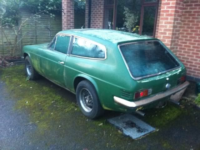

Had a Scimitar lined up but the owner has now backed out of the deal so got to look for another one of those now, got out bid on one on Ebay this morning ;frown:
