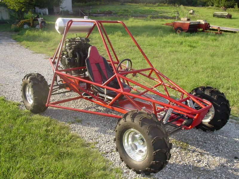

Basically I (along with a group of 6 other people) have been given the task of building a Badlands Sabretooth buggy, from scratch, to earn our stripes and make more steps towards no longer being called "budding engineers". All good stuff.
Here is what one should look like:

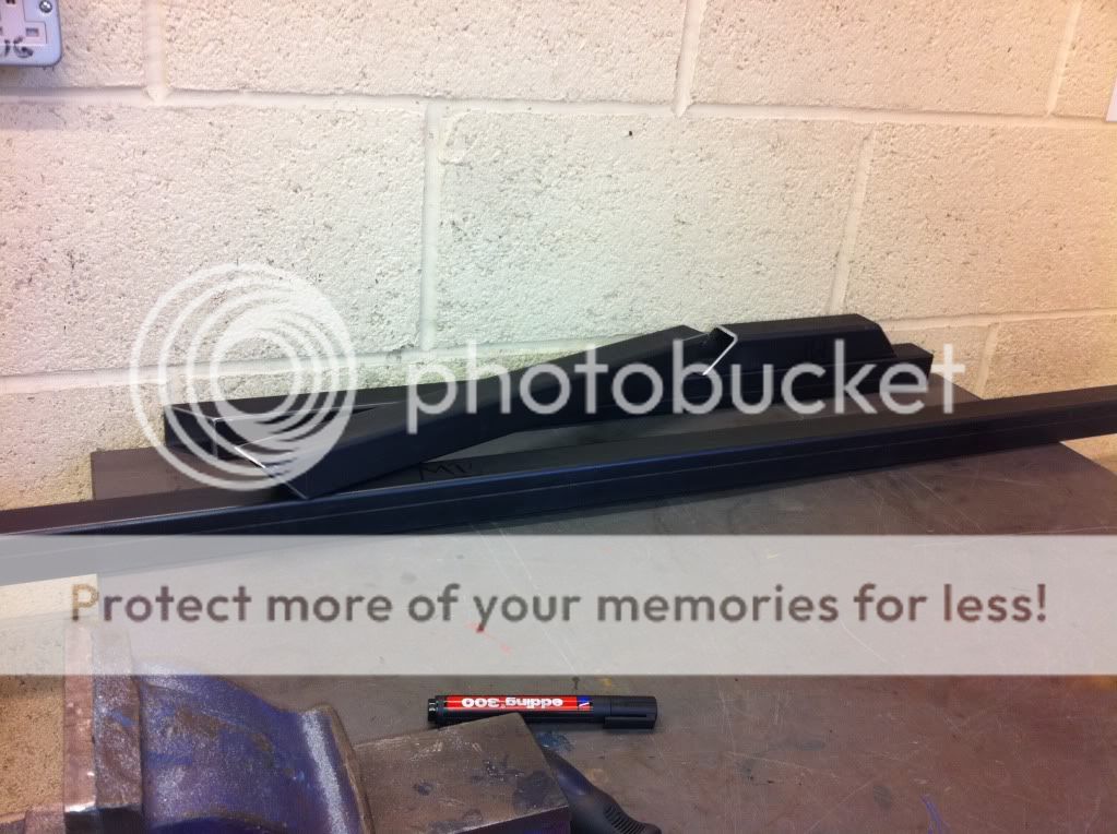

Today me and one of our group started work, marking up and cutting our steel for the floor pan.
The pan is constructed from 40mm X 40mm x 3mm box section, and we have made a start to cutting it to size, which will hopefully all be ready to tack together by the end of Thursday afternoon or Friday morning.

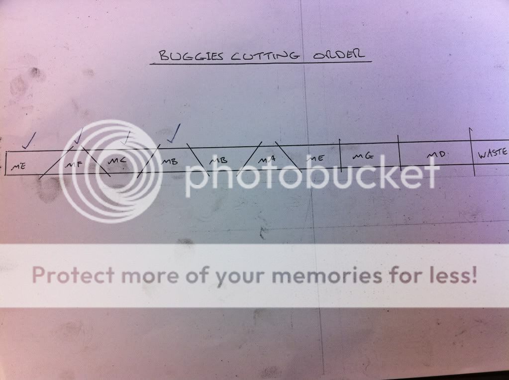

Here's a quick snap of the plans and our slight alterations:
We have made our own revisions - the two 1613mm Tube spats are being removed to save money but also because they are plain hideous.
The saving is also on the main central strut which was 1750mm but is now down to 500mm.

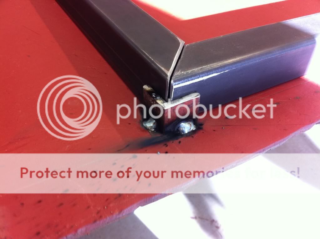

So here are our ghastly first cuts (we're all noobs here):

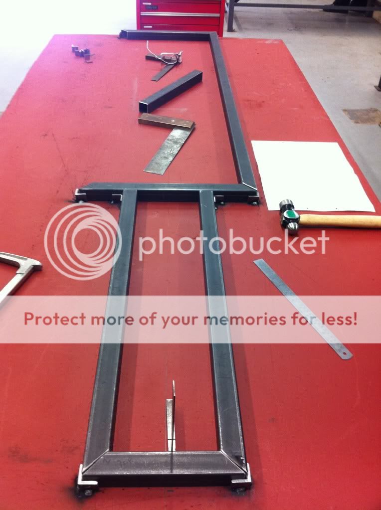

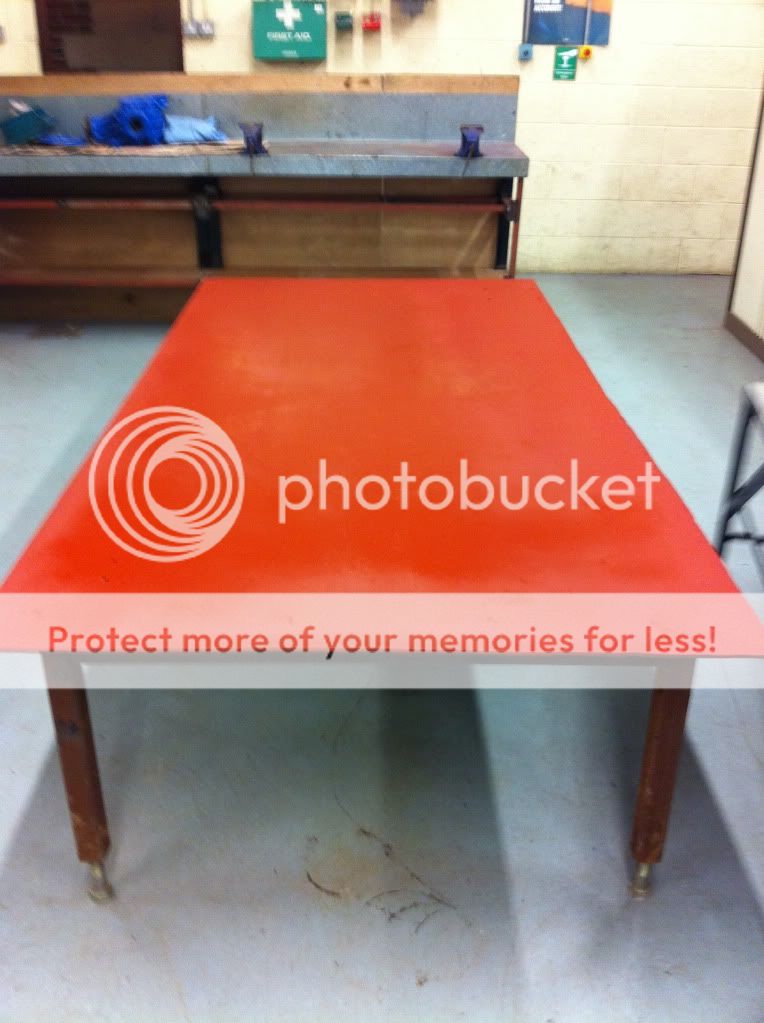

And finally, here is the table we'll be drawing the plans out onto and welding its shape from:

As predicted, we have only two cuts left to do and the table is ready for us to start tacking the chassis together on, which will be done tomorrow. Then we move onto the tube frames which the two people who need to make those cuts were working on. :D

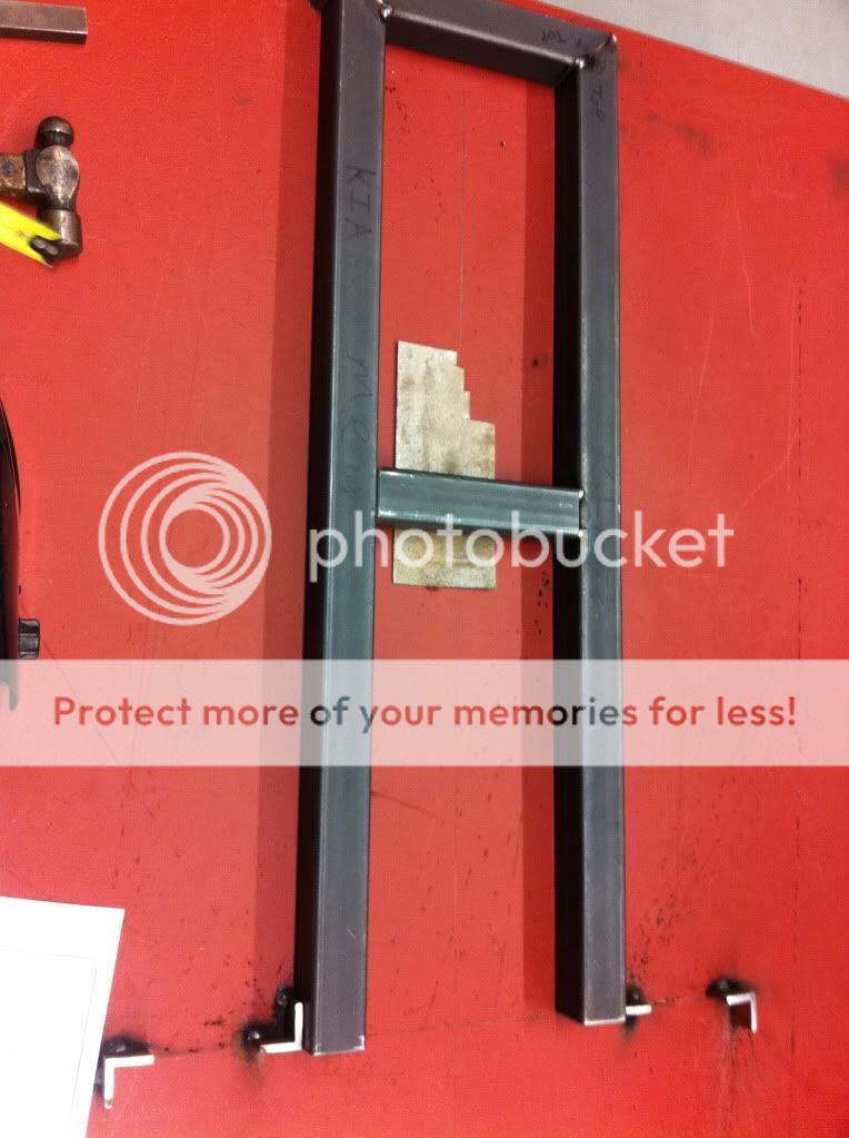

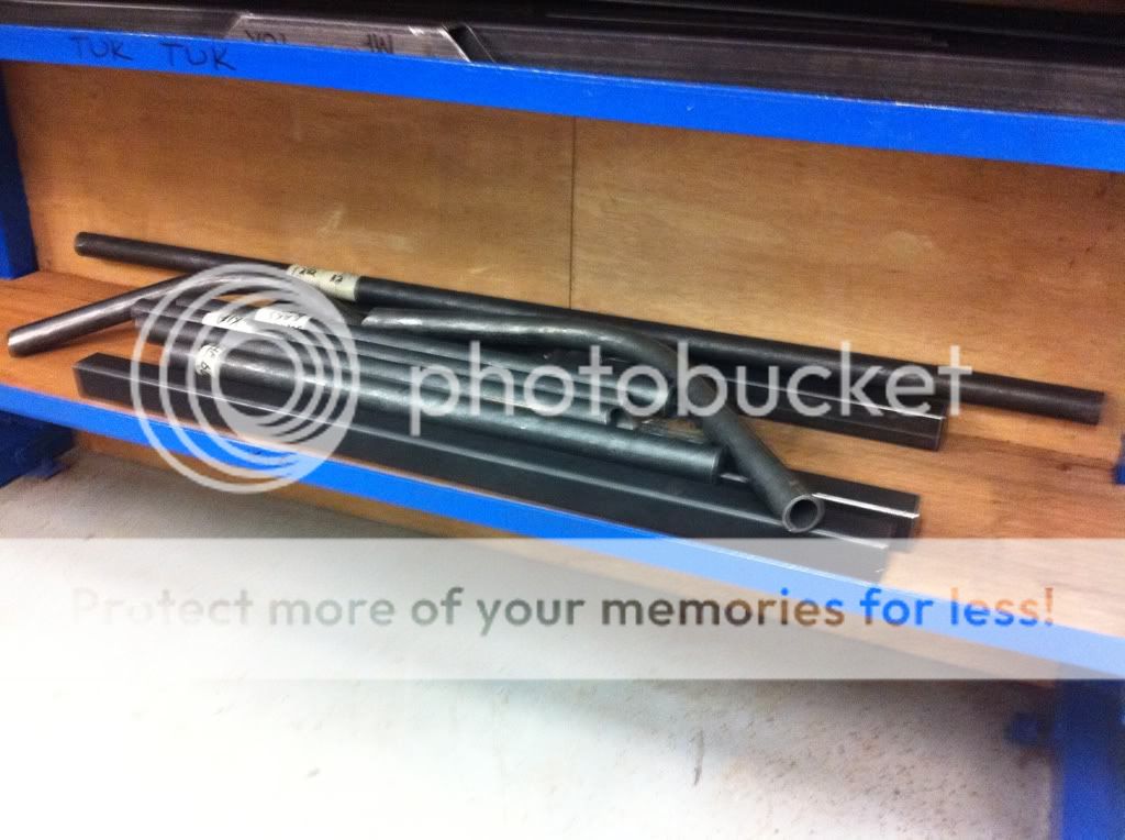

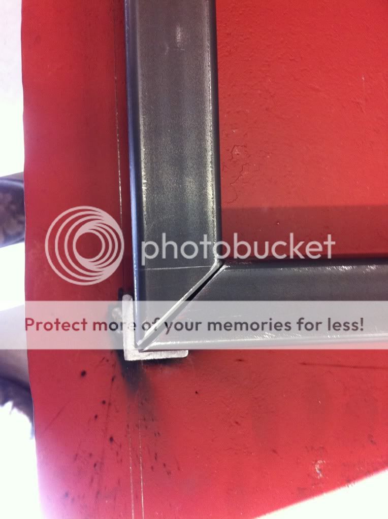

We have the floor pan tacked in certain areas, and most of it is filed/square and ready to weld. We also made a start on the tube frame, which will now doubt be cut, fish-mouthed and tacked onto the floor pan. Everyone's buzzed for this and we're making solid quality progress.

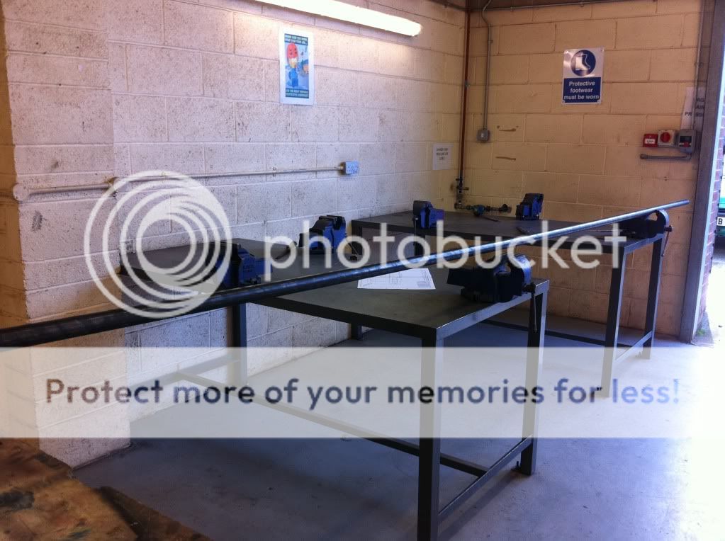

Jig made up and in use:
Roll hoop tubing:
Rear Section of Frame Partially Tacked and positioned, ready for welding:
Next session the Roll Hoop should be cut, bent and tacked in along with the front braces.
