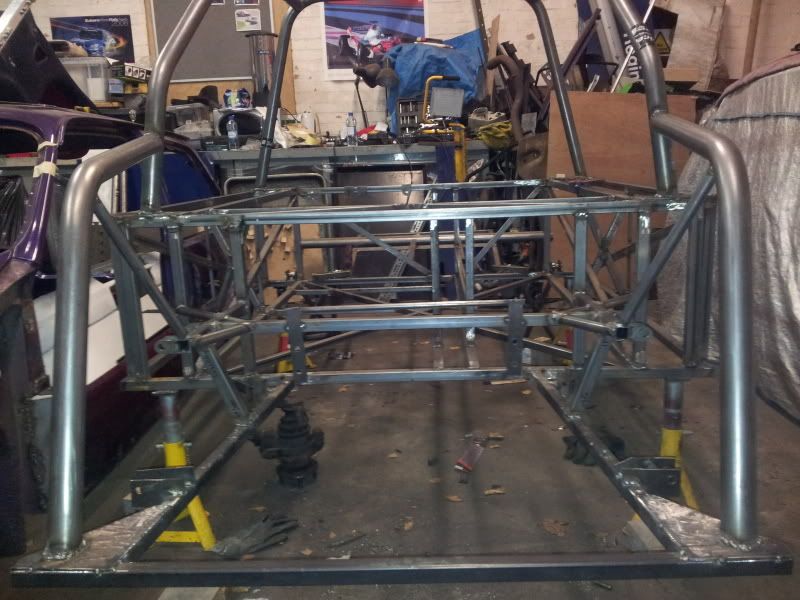

Postby vvcmetro » Fri Feb 03, 2012 12:13 am

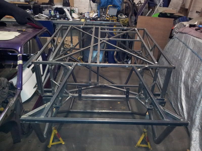

Well got the main part of the cage tacked in tonight, now tomorrow I can remove the body and start welding the whole thing together.

Postby vvcmetro » Fri Feb 03, 2012 2:16 pm
Lifted the body off the space frame this morning. Let the welding marathon begin.

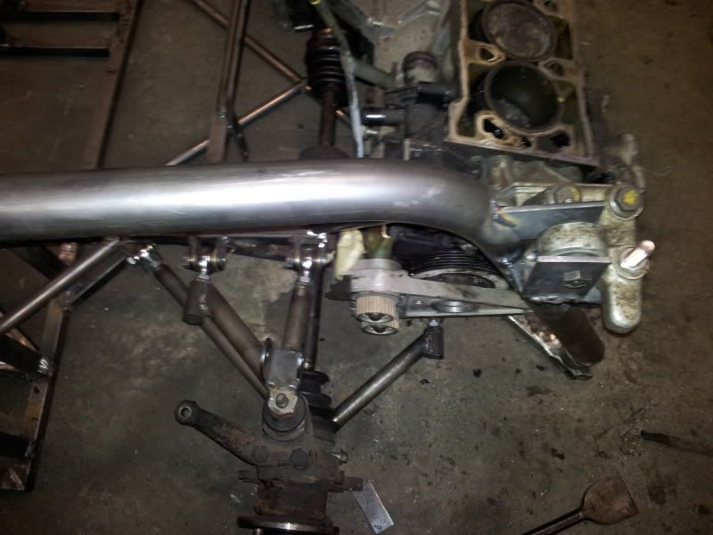

Postby vvcmetro » Sun Feb 05, 2012 10:13 am
Got the 'chassis leg' bits of the cage done, the engine mounts will hang off these, and shortened the front part of the space frame.

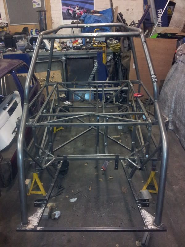

Postby vvcmetro » Sun Feb 05, 2012 9:31 pm
Spent 6 hrs down the workshop today on a weldathon, still a lot to do though. Also added some more bracing, from the top front suspension to the chassis leg on each side and also onto the diagonal internal bracing.

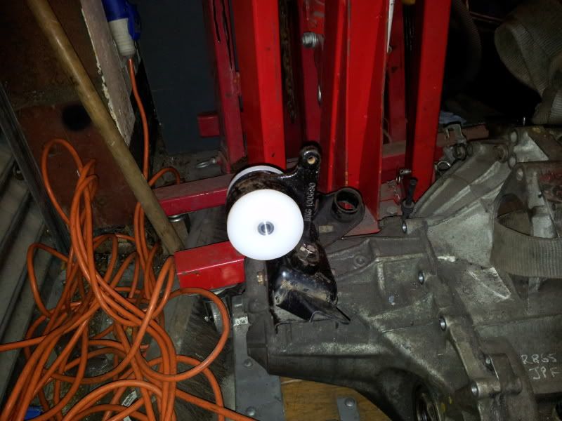

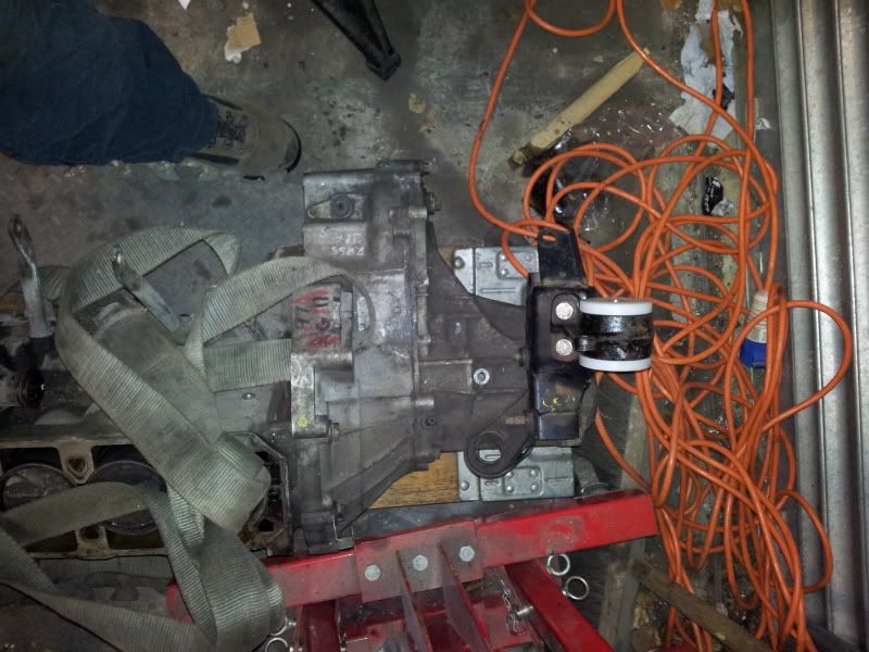

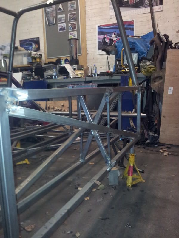

Postby vvcmetro » Wed Feb 08, 2012 11:29 pm
Picked up my gearbox mount today, I've had some nylon top hat bushes machined for it. Tonight, cut and welded in the main hoop diagonal. Then flipped the space frame over and started on welding up all the underside bits, and parts that are easier to weld with it upside down.

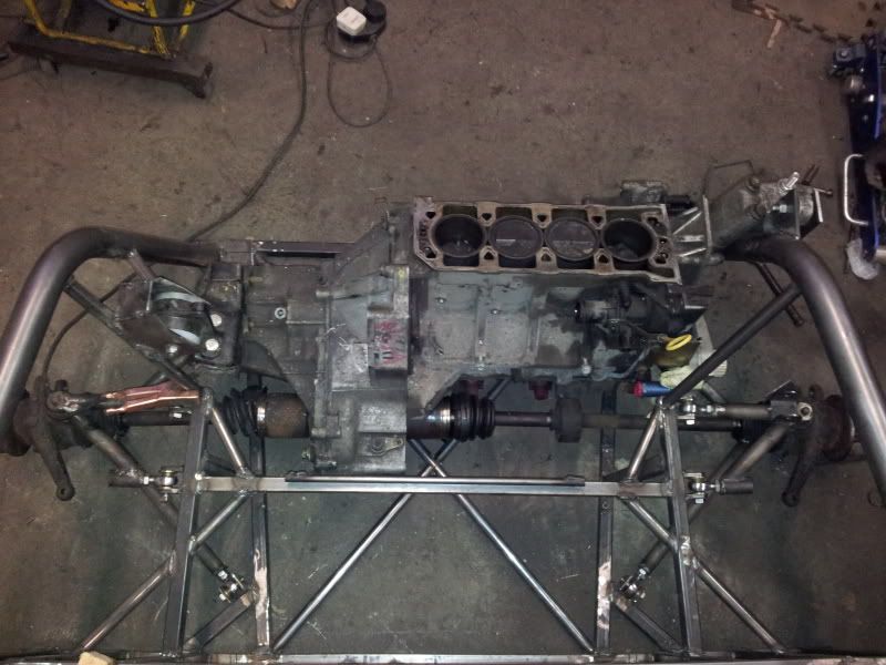

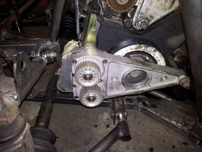

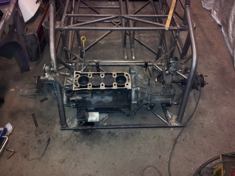

Postby vvcmetro » Sun Feb 12, 2012 8:52 am
Lots of swearing in the workshop yesterday, dropped the engine back in position - this time with the drive shafts on, so I could do the mounts. Well, I didn't have the engine far enough over when I dropped it in position to do the chassis legs. So had to cut the RHS one off and reposition it and add a 1" piece to the bottom at the front, I was having problems with it clearing the scavenge pump. It took a lot of time to get the engine in a position I was happy with, so the drive shafts were in the cups more or less an equal amount at the diff end. Also had to position the engine so the drive shafts cleared the scavenge pump.
The engine mounts aren't finished yet still got bracing some more bracing to add.

Postby vvcmetro » Sun Feb 12, 2012 10:37 pm
Finished fabricating the main engine mounts today, and welding up the engine bay cross brace. Also welded in some small angle iron for fastening the ally to.

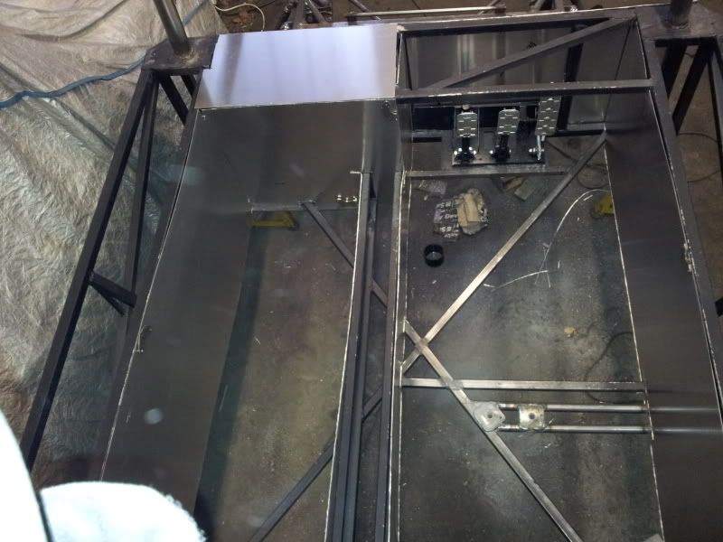

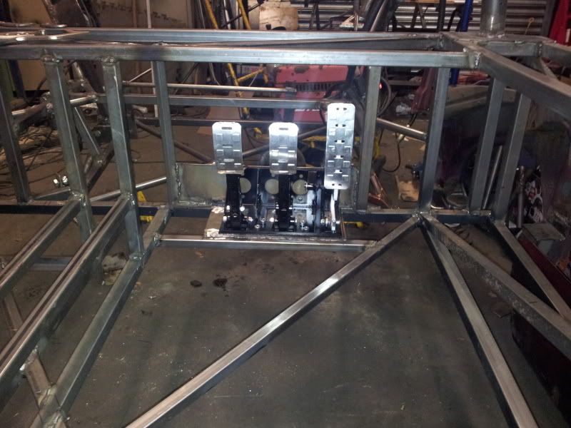

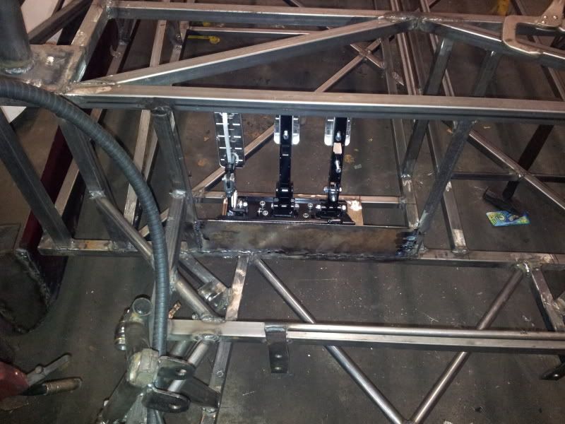

Postby vvcmetro » Mon Feb 13, 2012 11:39 pm
Pedal box arrived today, so got it's position worked out and welded in a length of box section and two pieces of stainless steel. Once piece for it to mount to and one piece to reinforce the bulkhead, as I don't trust 1mm ally to be strong enough for that particular role.

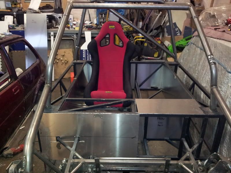

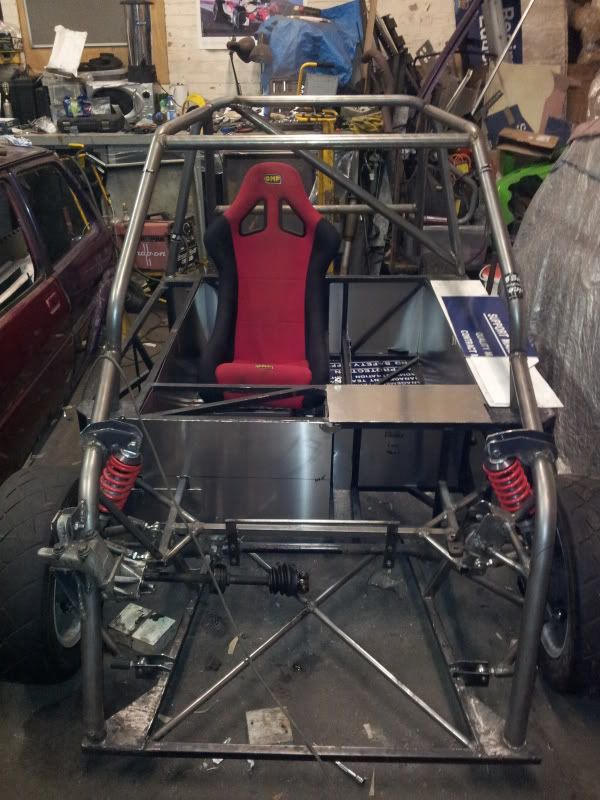

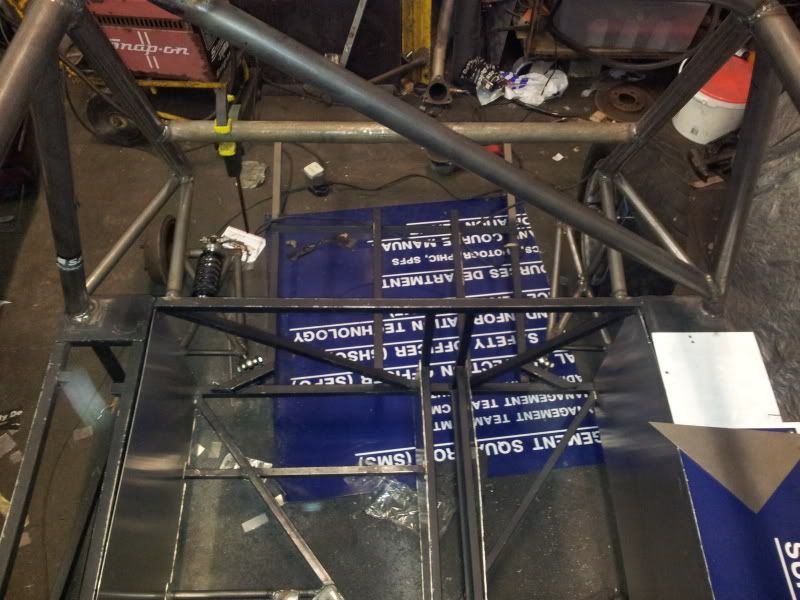

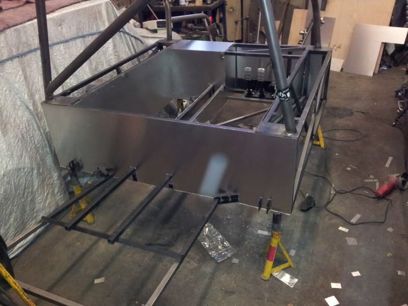

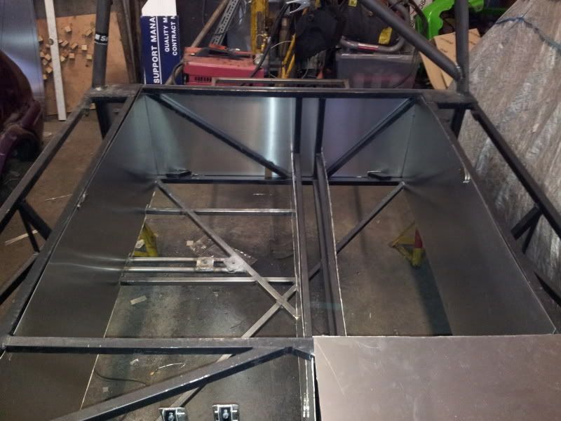

Postby vvcmetro » Tue Feb 21, 2012 7:32 pm
Had a mate come over at the weekend, who is an airframe technician at Brize Norton. We made up two of the panels required and then marked them up and drilled all the holes to aircraft standards. Today I made the rest of the panels bar the floor, tomorrow I have to mark them all up and drill all the holes. This will give you an idea of how the inside will look.

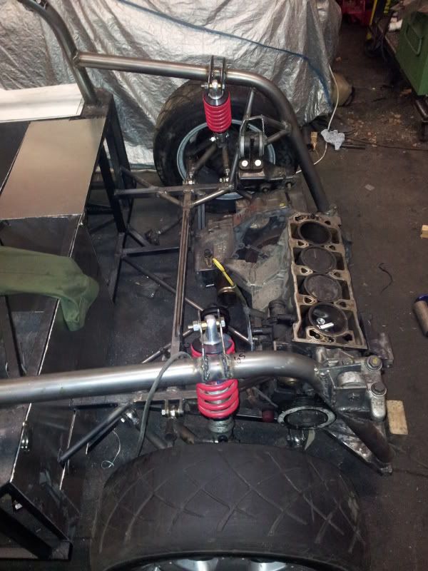

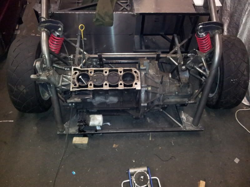

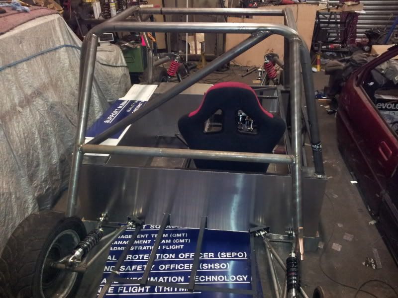

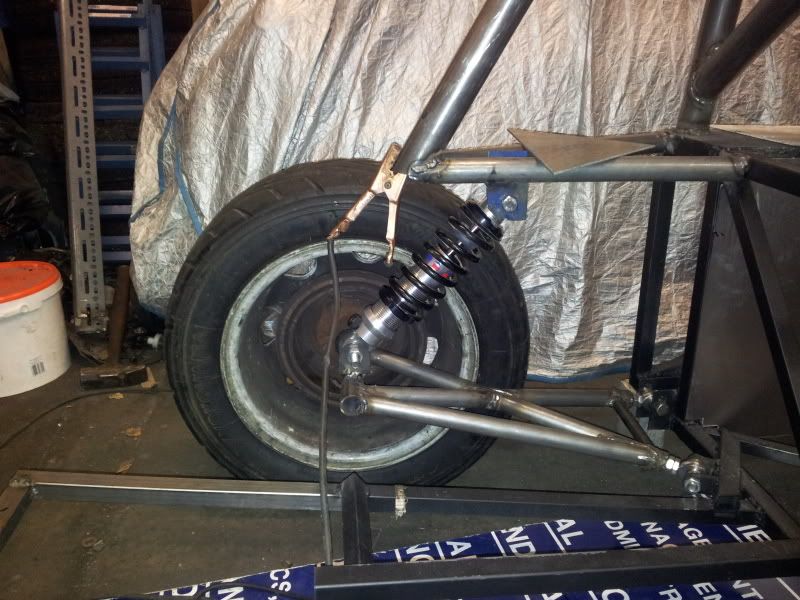

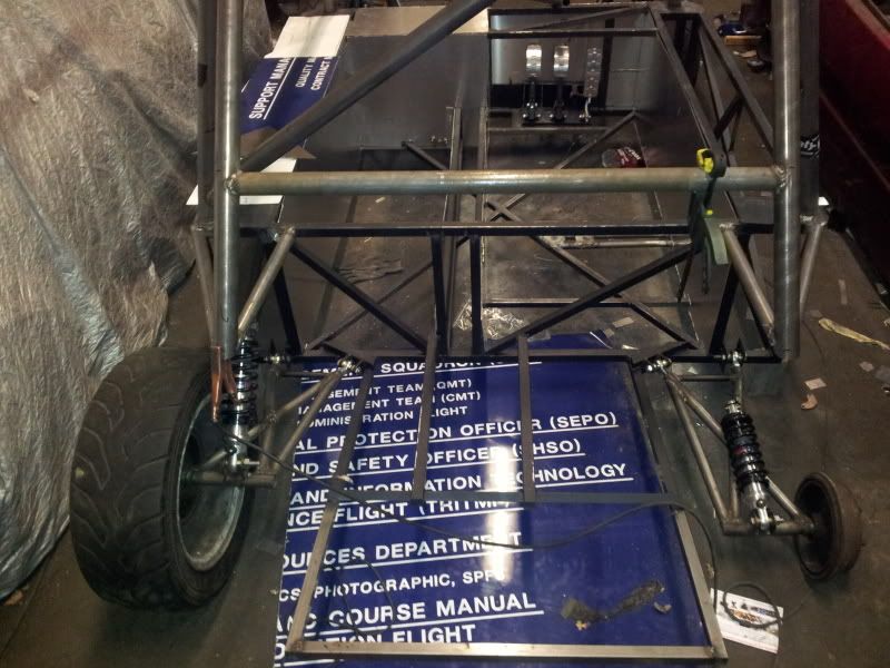

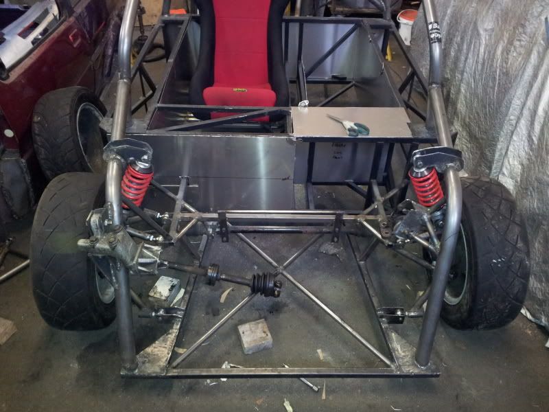

Postby vvcmetro » Wed Feb 22, 2012 9:40 pm
Today was a mile stone, the car is now stood on it's front wheels. I fabricated the front coilover mounts and fitted them, my new rear coilovers arrived today as well. I cut and fitted the rear backstays and harness bar ready for fitting the rear coilovers, hopefully by sunday I will have the car sat on its wheels.

Postby vvcmetro » Sat Feb 25, 2012 9:07 am
Welded in the bracing for the cage back stays and looked at the rear suspension mounting. Not happy with it, so looking at two solutions:
1. Put the bottom coilover mount on the rear/side of the tube with the stub axle in it.
2. But the braces off, angle them up and shorten the back stays.
3. Do both 1 and 2
Will look at the best solution today or tomorrow. Also dropped the engine back in the front, the whole lot has to go on the trailer next week to travel to it's new home in Ripon on the 6th March. I hate moving house.
