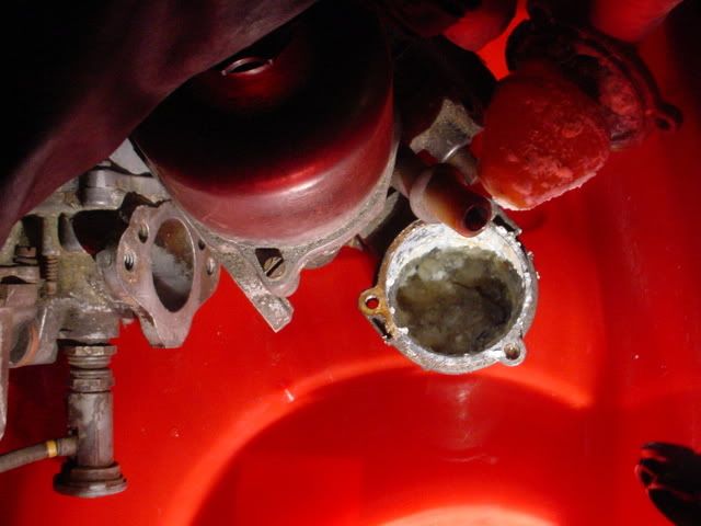

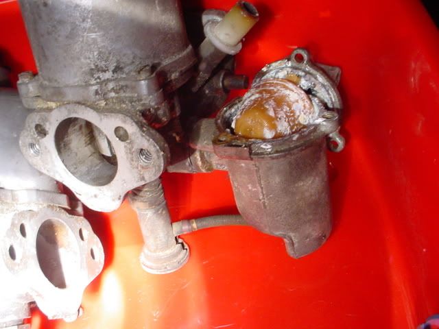

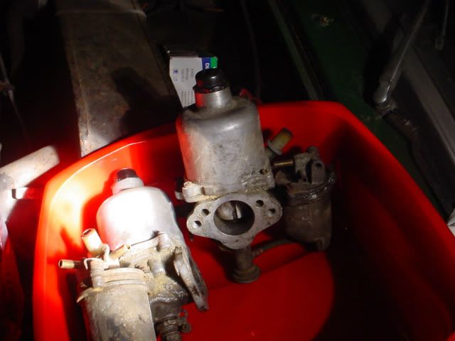

Bit more of a meagre update but a few more photies. I'll deal with the carbs first.

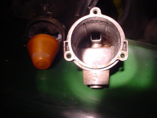

I'd taken them off the car already so I decided to give the sludgey one a clean. Here they are looking very fetching (thats fetching not felching)

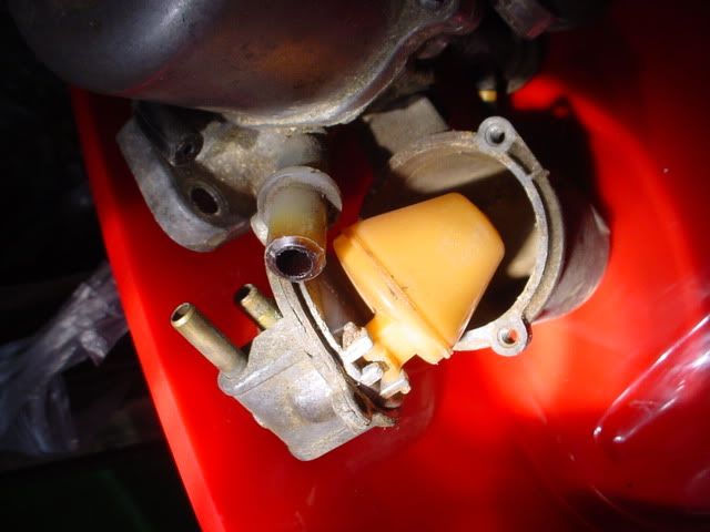

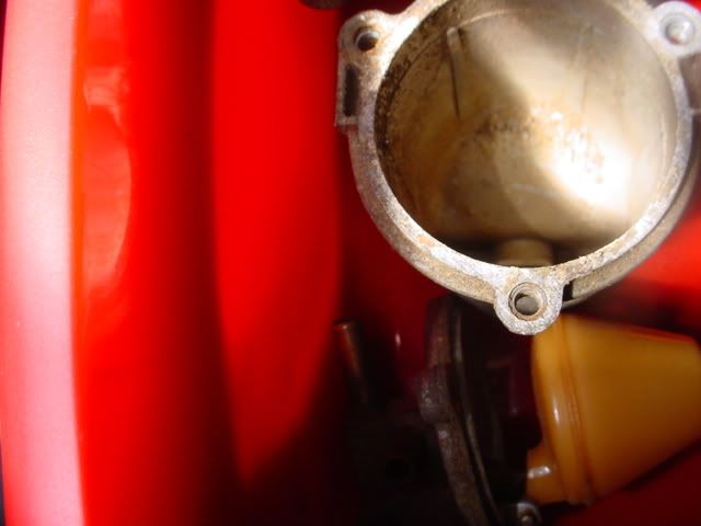

Popped top of sludgey - yuck!
Popped top of oily - empty

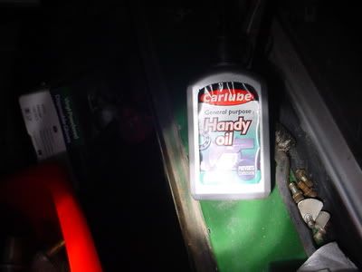

Oil I had lying around that I filled both the carbs up with to see if they would still damp properly when filled:
Which worked well although oily still leaked all over me.
Then gave sludgey a going over with some Gunk which worked well although I probably needed some additional brushes and to leave it for a while to work. Result after 5 minutes scrubbing and 10 minutes flushing out the float bowl:

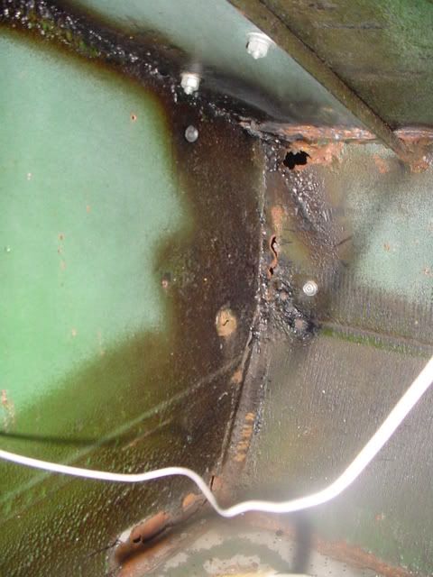

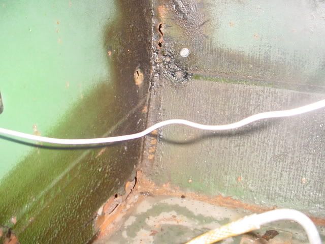

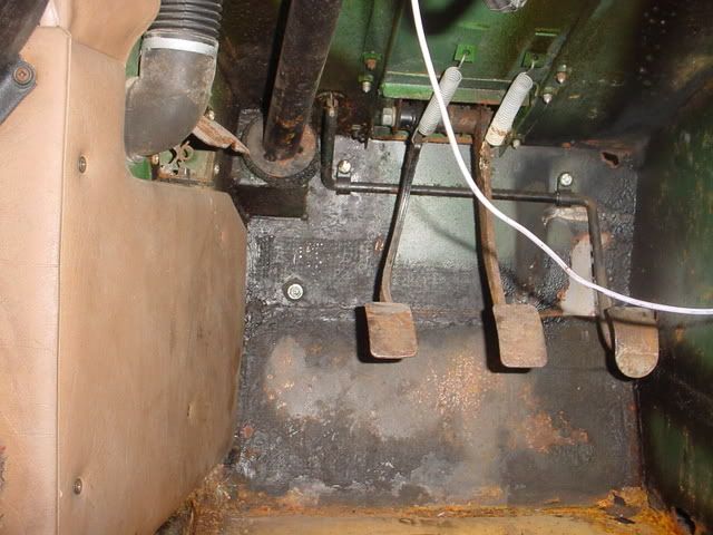

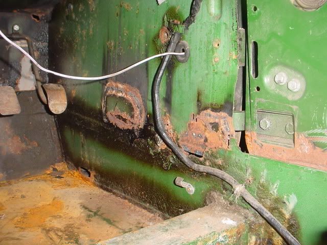

Now for more photos of the rust - this time I went for some sexy interior shots!
Drivers footwell
Not too bad but it does look like the patches were welded on without even cleaning the paint off first.
Passenger footwell
Not sure how best it will be to handle te bit of rust down in the bottom corner there, anyone got any good ideas besides chopping out from below to get access?
Is it better to cut out all the rusty bits including the bodgey welded panels then weld back in fresh or just treat them with stuff until they get to the point it needs it badly and weld in repairs around the crap bodges? I know which I think I should do but I'm interested in opinions on it.

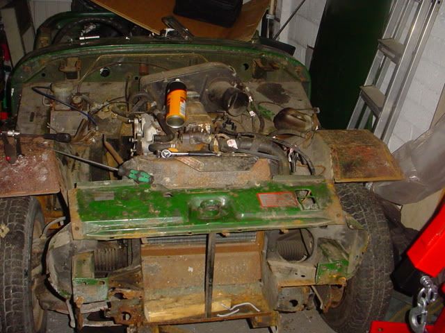

Continued stripping stuff off the Midget. It now looks like this:
So all the removable panels are now stored in the attic. I removed the rad yesterday too after the photo was taken. Seems to be good and leak free as it was still full of manky (black!) coolant. So thats also stored neatly away for the rebuild.
Drained the oil out as the plan is to whip the engine out this weekend or early next week to get full access to the engine bay and underside for the cleanup.
The oil was worryingly thin/watery when dropped. No mayonaise to speak of but the oil filter appeared to be full of water but it wasn't giving the usual mayo look. Could it be old (i.e. unsmelly) petrol? :think:

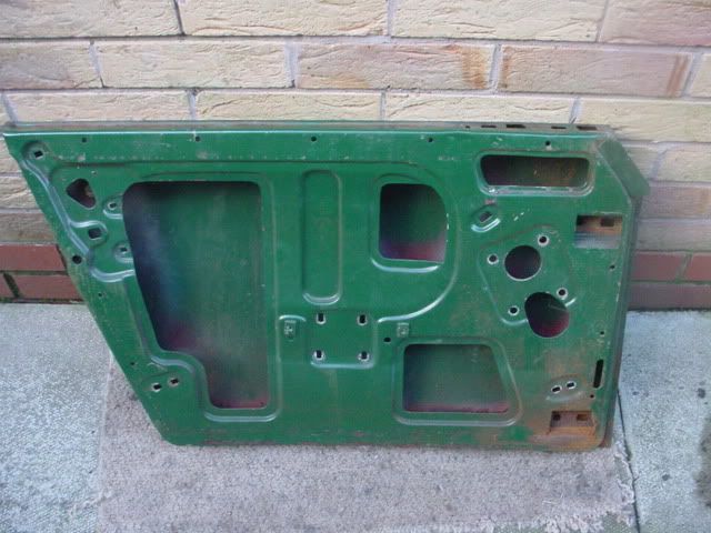

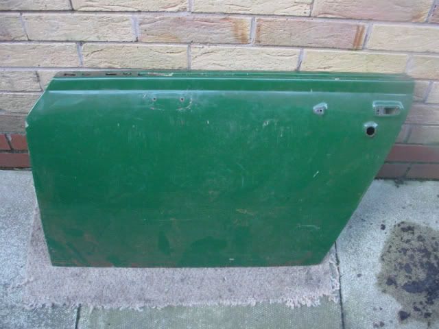

My first replacement door arrived too! £15 bargain.

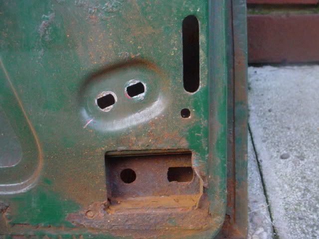

Worst bit:
As you can see a bit of rust on the bottom of it but otherwise sound. So I gave it a good clean up with that Marine Clean stuff, then filled it up with Metal Prep& Ready http://www.frost.co.uk/automotive-rust-products/por15-rust-solutions/por15-prep-ready-946ml.html I'll keep topping up and scrubbing it until it's taken care of the rust on the inside. I'll probably give the inside bottom of the door a coating of POR15 Paint too once the Prep and Ready has done its thing as the Midget door seals aren't the greatest and will inevitably let water in.
And just to protect my sanity I offered up the new door to the old chassis. Perfect fit once gapped using some thick cardboard. :D
