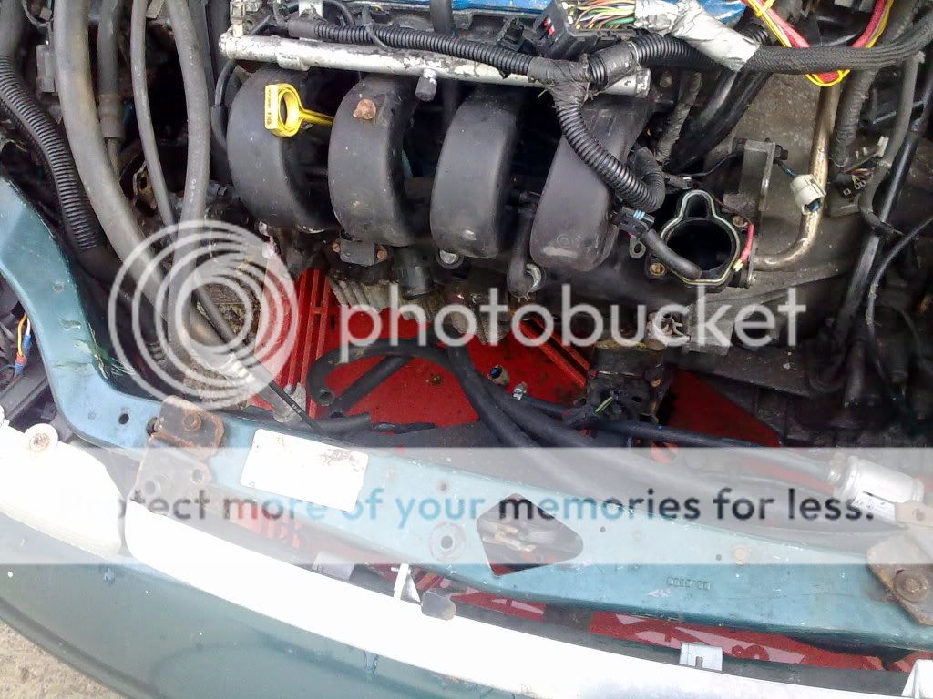

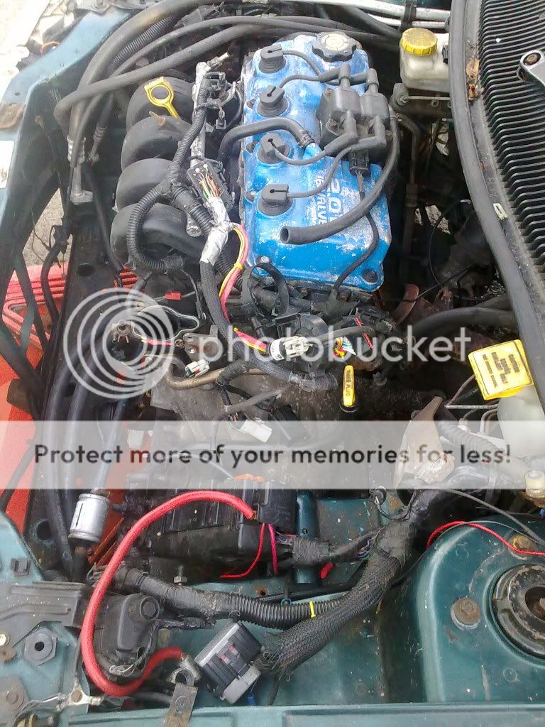

This is how my engine bay looked before I started

How my engine bay looks today?
Well the following have been removed or disconnected.
Stater motor (removed)
A/C Compressor (removed)
Power Steering Pump
(still plumbed in but removed from engine to be used on new engine)
Air intake to a& including Throttle body (removed)
Engines Electrics (disconnected)
4 pot ecu (removed)
LPG ecu and wiring system (removed)
Battery & tray (removed)
Radiator & Comdensor (removed)
Exhaust Manifold (removed)
All cables to the throttle and gearbox (disconnected)
Drive Shafts (removed)
Yes the cooling system has been drained and disconnected
for the engine, the automatic gearbox and the LPG System
