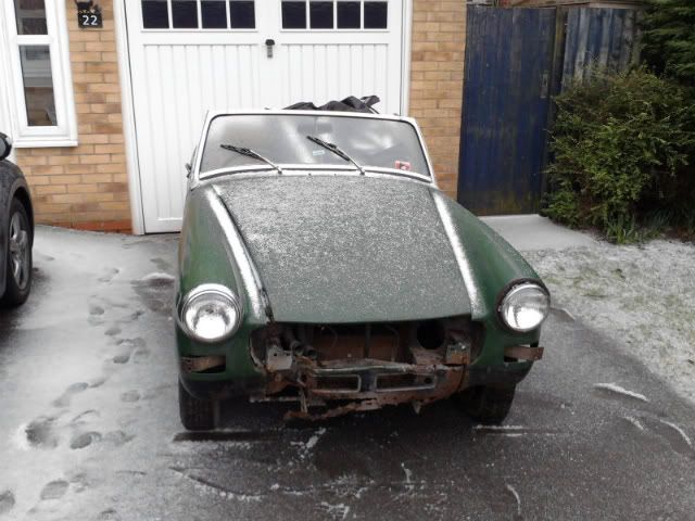

Well I said I wouldn't post anymore on my new project until I bought something and so I've gone and bought a 1979 1500 Midget!
Saw it this morning, paid cash and had it back at mine for 2pm. Here's the old girl:
Originally a rumber (thats rubber bumper) model but the bumpers are now missing. This is a familiar story with the rest of the car, the interior is a pair of seats. They are nice tan leather ones though and look like an afternoon with some leather cleaner will reap rewards as they're not scuffed or torn.
The eagle eyed of you will notice that it has a small amount of rust and a dent in the front valence. This is just the valence and its that rotten that a replacement one is a requirement anyway. The doors are a state, the bottom half of both has been chopped off and strips of steel roughly welded in place but they're not butt welded so they're horrible. Saving them looks like an exercise in futility so my best bet is a couple of replacement doors - new skins are £50 but I can get whole second hand doors for less than that which is a bit more tempting. Other patches have been welded in on rusty areas, they're solid but look an eyesore. A couple will need redoing but the shell is otherwise solid and not twisted.
The hood is torn in a few places but a new vinyl one is only £130 and a new Mohair one only £300.
The engine is the 1500 but I've no idea if it works or not, neither has the guy who sold me it as he'd only had it a week from a company that had 50+ cars and was shutting doors. He only really wanted the minis so all the other stuff (salmon pink beetle converible anyone?) he was shuffling on quick.

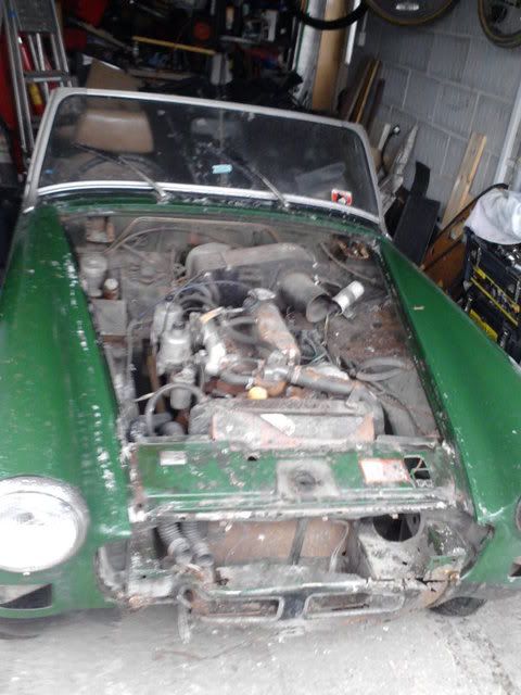

As far as the engien is concerned I've looked it over, it has oil and water in it, turned over easy (but you can feel some compression) with a set of mole grips on the crank pulley (there is no V belt though). Connected a battery up and got lights on the dash so that was nice, thought I'd give it a whirl so out with the liverpool locksmith and the engine turned over on the starter but VERY VERY slowly. THought it might be the battery so I tried jumping it off the jag - still only VERY slow. Anyone any ideas what could be making it so slow? Crappy old oil? Knackered starter? I wasn't expectiing it to start just wanted to see it turn over at the sensible speed.

Postby Renrut » Sun Feb 05, 2012 10:46 pm
Its one of these engines:
Which is supposed to be the same as the spitfire. THey are horrible looking engines, the inlet manifold is actually bolted to the exhaust, so much for cold air intakes. I've never liked the whole non-crossflow head style so might dig to see what else fits with minimal effort.
